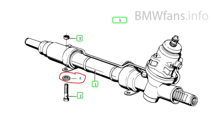

    One thread suggests that the Steering Rack Bushings can cause wobbly suspension feel when worn out. I could not find the Rack Bushings when inspecting the car (see pix). Are those item #4 on the parts catalog ? If so, they seem to be discontinued. Does anyone know their part number and if can be seen in my picture?

    Click image for larger version  Name:	Steering bushing parts manual.JPG Views:	0 Size:	47.6 KB ID:	9960972

    I believe they talk about the u-joints and the rubber disk of this part https://www.ebay.com/itm/BMW-E30-STE...EAAOSw6atfN9Db
    Your steering rack looks different from mine. Mine has an aluminum tube.
    Maybe, it comes from a different BMW model, and it's installed incorrectly.

      My Steering Rack might have been changed by the previous owner by a different one. I see that you are referring to the Steering Coupling "Guibo". It seems mine is OK, but tomorrow I will check under daylight.
