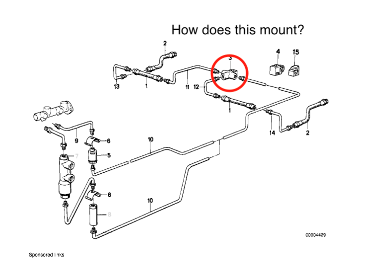

    34341111435 - Rear Brake Line Distribution Piece Mounting
    Hey r3v - hoping someone can help me out. I'm doing a subframe refresh and in the process discovered that my brake hard lines are in pretty poor shape. My rear brake distribution piece was so bad that I literally cannot tell how it was mounted to the underside of the car. I can (and will) easily order a new distribution piece, but the mounting mechanism is literally gone and I cannot tell how it's mounted by looking at RealOEM. Is there a stud welded to the body that takes a nut? Or is (was) there a threaded insert that takes a bolt and a washer to hold the distribution piece on? Anyone have part numbers?
    Thanks!

    I googled pictures for you.
    It's a bracket welded to the body. A bolt is used to mount the junction.

      Thanks! I must not have been googling right. Couldn't find any good pics when I looked.
