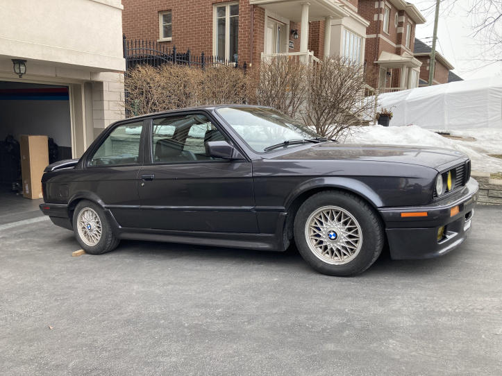

    I just got a 318is and already had a built S54 ready to swap before I even bought the car. I plan to do a complete overhaul of the car after I am done with my LSB E46 M3.
    I’ve been lurking this forum for a while, reading differents thread to try to build a nice & fast E30. I initially was going to do the 5-lugs conversion but the more I read about it, I am not sure anymore. I would like to get KW V3 coilovers. Not sure if I get the non-M or M3 version, will depend if I stick 4x100 or switch to 5x120.
    I saw those AP Racing front & rear BBK on CAtuned and was wondering if anybody here have them? Would it be enough on track with 285mmx24mm to dissipate heat of an E30 with around 320-330whp?
    I plan to do 750 Master cylinder and 944 brake booster swap, Gulf RF800 fluids and good track pads (usually like Performance Friction 11 compound).
    In the future, car will see 80% street & 20% track. Maybe more track will see.
    Also, on CAtuned it mention that it will need small spacers to clear calipers. What kind of spacers thickness would it need to clear BBS RS 001?
    Thanks for your help
    Here is the car right now, it’s sitting on HSD coilovers without rear height adjusters under rear springs, it’s low and exhaust line scrape on speed bumps…

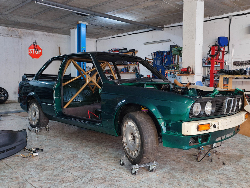

                      • Gtfour
                        • Apr 2023
                        • 63
                        2003.5 BMW E46 M3 Laguna Seca Blue/LSB 6mt
                        2006 BMW E46 M3 Individual Estoril Blue/Black 6mt
                        2024 Toyota Land Cruiser Black
                        • maxkarmonkey
                          • Jan 2024
                          • 2
                          Hello, new here, did you ordered the bbk from catuned?
                          im in the same boat as you, building a 318i with s54 and im desperate looking for a brake setup!! My english is not that good, have been watching the youtube video but cant understand what he really wants to say about big brake kits
