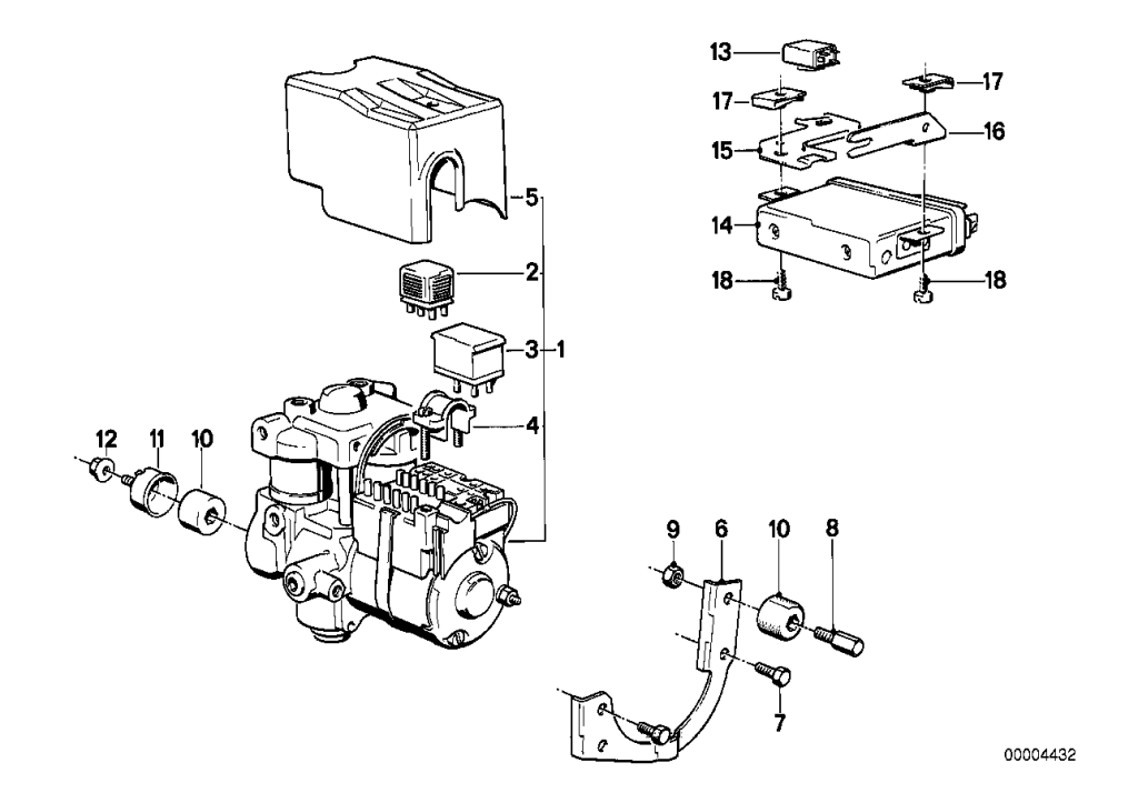

    e30 abs is independent of the ecu. it has it's own stand alone module.
    Click image for larger version  Name:	diag_3f4.png Views:	0 Size:	147.2 KB ID:	10109618
    number 14.
    edit : to test a bad sensor. unplug each sensor at the wheel one at a time, when the abs light goes out, you've found the bad one.
    • PEZ2
      • 50
      Check part 13 in the diagram above. It has an internal “fuse” to protect the abs brain , item 14 above. All of which is under the dash left side.

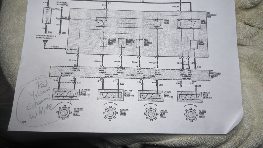

              Next up is to get the wiring schematic for the control unit plug and check the wiring from the sensor the the control unit.

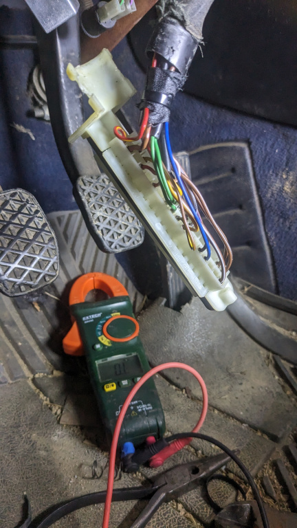

                Still no joy on getting ABS dash light to go out.
                The sensors check OK
                The sensor wiring to the control unit plug are OK
                The overvoltage relay is OK
                The ABS control unit is OK
                The ABS hydraulic unit sensors visually look fine.
                Based on schematic not sure what else needs checking.
                ideas?​
