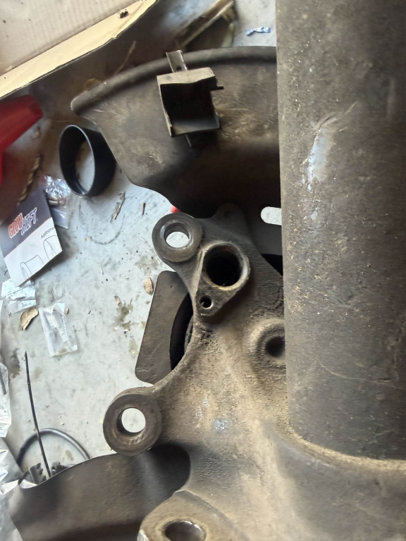

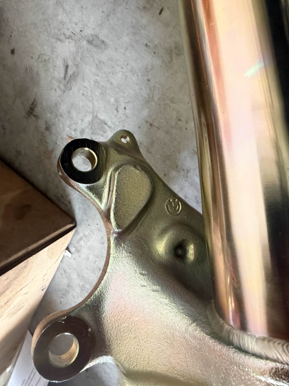

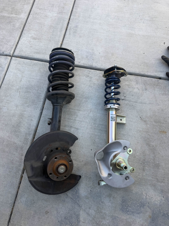

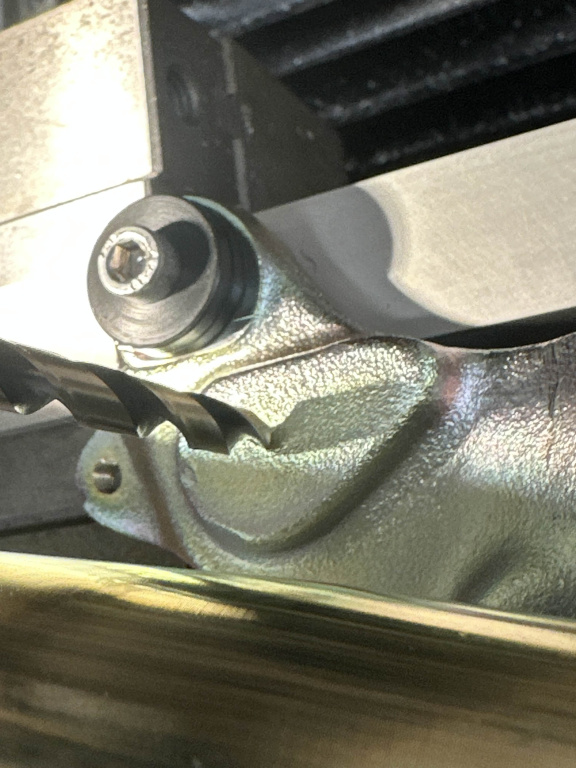

    Drilling wheel speed sensor holes in Non ABS hubs.
    Hey guys, just got in my coilovers from Gefahrenewelt and I accidentally sent him non abs hubs, but I thought it would be simple to just drill some holes in them, yeah turns out the bosses are slightly different... I 3D scanned both and compared them and the boss on the non ABS hub is like 2mm off of the ABS hub. Just wondering if anyone has attempted this before, or tried anything. How much does the spacing on the VR sensor matter? I was thinking of just making it fit and aligning it to the center of the boss on the non abs hub. I am going to be running MK60E5 with a Happy Cactus VR/Hall Converter and I think it'd be easier to drill to E30 WSS size than it would be to retrofit E90 sensors and tone rings all around but let me know what you guys think. Thanks for your time.
