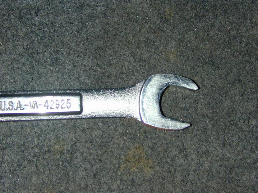

    I just cut part of the bushing with a utility knife when I did mine. Don't need a shaved wrench but ymmv.
    • xLibelle
      • Aug 2004
      • 2673
      yeah, i figure it will cut easily with a knife...
      but check out my first picture. The nut is positioned on the same plane as the slot. Can you not recall how close that framework was to the nut?
      When i did the test fitment, I was unable to make complete turns. (the kind where you turn enough so you can fit the wrench upsidedown, so on and so on)
      • Dirtbleed
        • 495
        modify a tool. A shaved stubby would work even better.
        • whodwho
          • Jun 2008
          • 1547
          Originally posted by xLibelle
          yeah, at this point, i'm not concerned about cutting the bushing.
          more interested in the wrench used to tighten down that nut. there is limited vertical space which would require the wrench to be shaved. seems it might be an issue of being slightly more difficult to have the nut there, than the toe adjustment.
          Thinking the scenerio out over and over, its looking like it would be smarter to install the bolt from outside-inward.
          If you installed out-in and you needed to pull the TAs later you might be able to slide the bolt out some and cut the head and reinstall reversed?
          Should be enough room for a sawzall?
