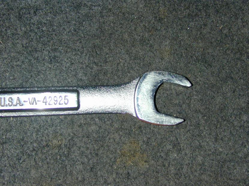

                        those of you with this setup, how are you getting to the outer most nut? I can get a box end wrench on the nut, but then I have absolutely no space to loosen/tighten it. My cone wrenches don't work either. I've seen someone cut holes in the body but i'm not ready to do that yet.

                              I grinded down a wrench to tighten the outer nuts
