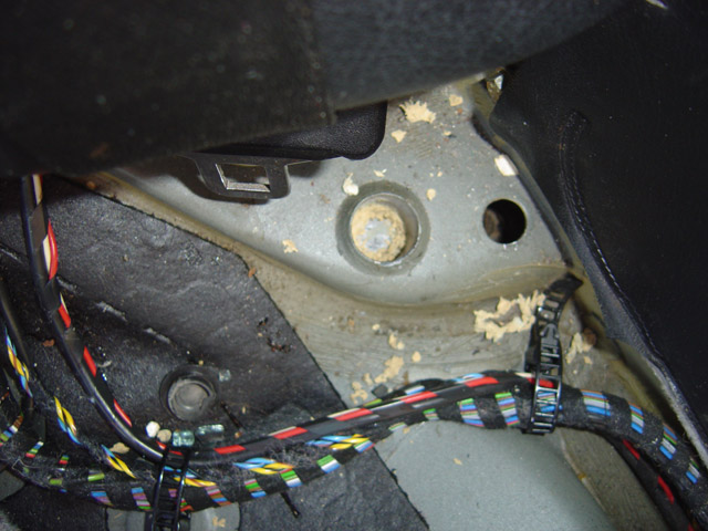

                  #68
                  Originally posted by coupeowner
                  #2 is accessed from under the back seat. May take an air hammer to pop it up. The bushings can be removed w/ the subframe in place but it requires a tool or a torch. Being that you can make a tool for a few bucks,
                  I would go that way.
                  How do you access that #2 bolt from under the back seat. I pulled my back seat out and dont see any way to get at it. I made the tool you listed there and my bushings are going to be here on tuesday.
                  Thanks

                      #70
                      Im pretty sure that this is where your suppose to access the bolt but the hole was filled some rubber. I got most of it out with a screw driver and at the bottome of the hole its just sheet metal.... What gives?
                      Is the '91 318is different? Can I not access the long bolt from under the back seat?
                      I was planning on taking out the bushings without removing the whole subframe. Any input would be GREATLY appreciated.
                      Thanks
                      • zerofreez
                        • Sep 2004
                        • 57
                        #71
                        Nevermind, the bolt doesnt have a regular head on it, it has a flat circular head on it and threw me off.
