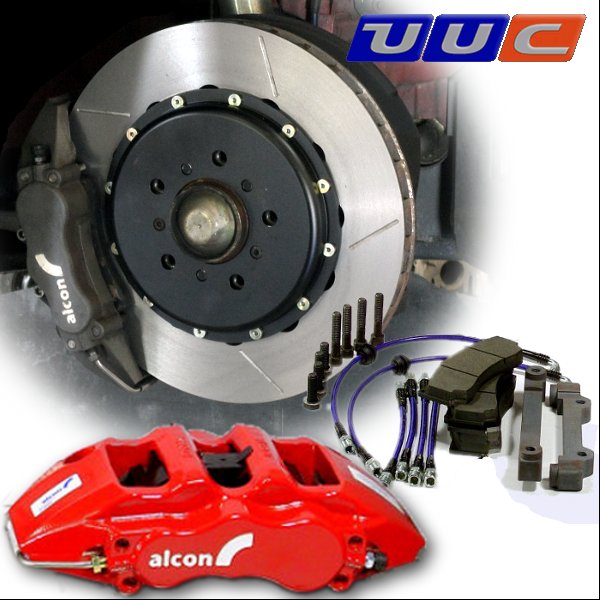

Competition calipers are anodized or plated to better evacuate heat. Performance Friction calipers are anodized, Brembo GTR calipers are anodized or plated (the regular GT are street application and of garden variety). Alcon Mono6 are anodized. And wether it is oil paint or plastic powder coat, it still is a thick crust over aluminum, and it still traps heat. Not to mention it will discolore if reaching high temps. We all know what happens to the Brembos on Mitsubishi Evos and Subis at track days... They turn to a muddy brown color.
From Alcon's website
"As for performance, Alcon has also addressed the important aspect of aesthetics with the Mono6. The hard anodised caliper body may be left in its normal ..."
Brembo website
"The finish on the GT-R calipers is nickel plating to avoid corrosion."
According to Bimmerworld
"The 4-piston Z31 caliper used in the front on this E46 kit is a Monobloc design... Calipers are finished with a black anodized surface."
Indeed every detail counts in a caliper. Surely, finish counts, but also the number of piston sizes/configurations available. How the pads are retained in the caliper. Pad compound thickness (8.5mm vs 16mm for a 7420 - Superlite clamper). Pad area. Which company is the manufacturer. Data in claims when it comes to stiffness. And especially to what type of duty the kit is designed for.
Nonetheless, beyond blanket statements extensively using the word "better" as a comparative mean, it would be proper to add to what it is compared, otherwise it could be misleading. Sometimes, the word "improved" is more adequate, as it most likely refers to a previous version of the same kit. ;-)
