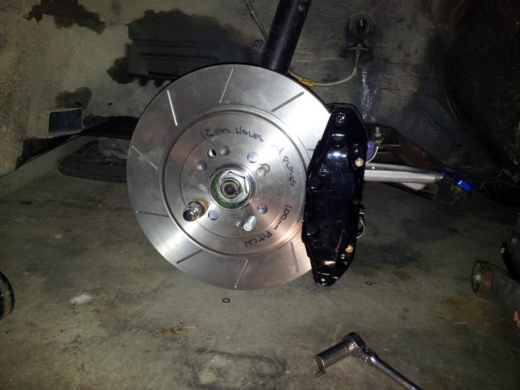

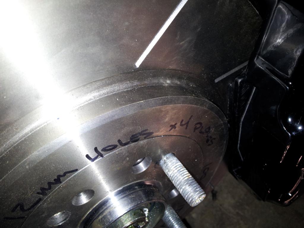

    Hot damn I'm done.
  • E30RedtopSR
    • 202

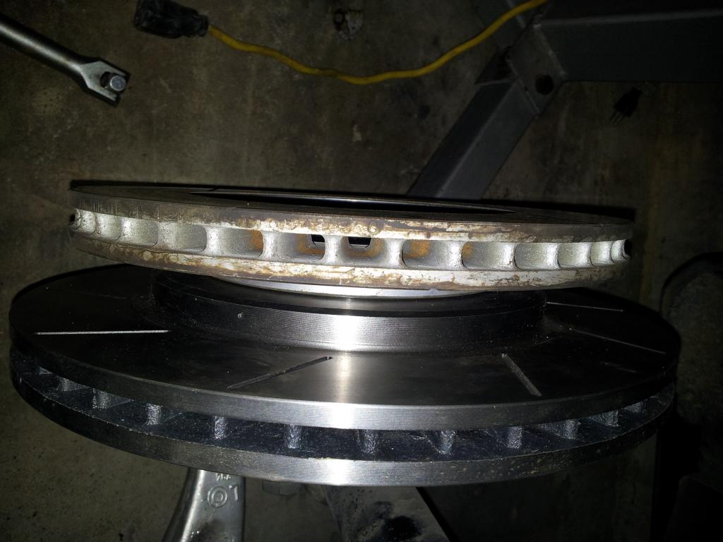

    BBK done
    Done!
    Test drive this spring!
    304mm rotors from 02 and newer MG TF coupe. Shipped from the U.K. "mintbitz" on Ebay is best.
    24mm thick
    4 piston aluminum Mitsubishi 3000gt VR4 1995 to 1999 or Dodge stealth R/T TT 1994 to1996.
    Caliper bracket is from the RX7 caliper bracket guy, (thanks bro if your on here i cant give you the secret) slightly modified.
    19mm master with massive booster delete.
    550 bucks start to finish using New rotors, reman calipers and new master, and machine work. Your final cost may vary.
    Hub bore was opened up to E30 diameter.pattern redrilled to 4x100.

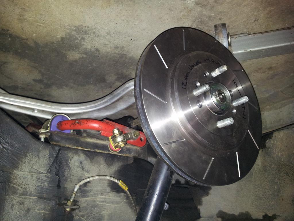

      before shimming....dont freak out

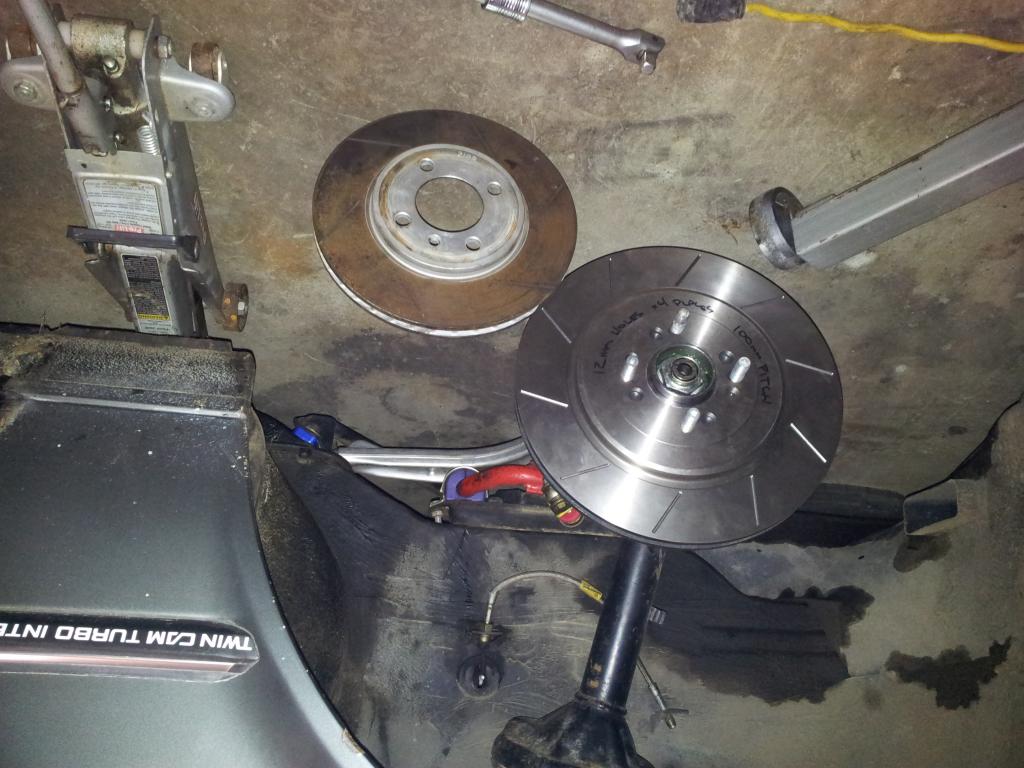

        moar

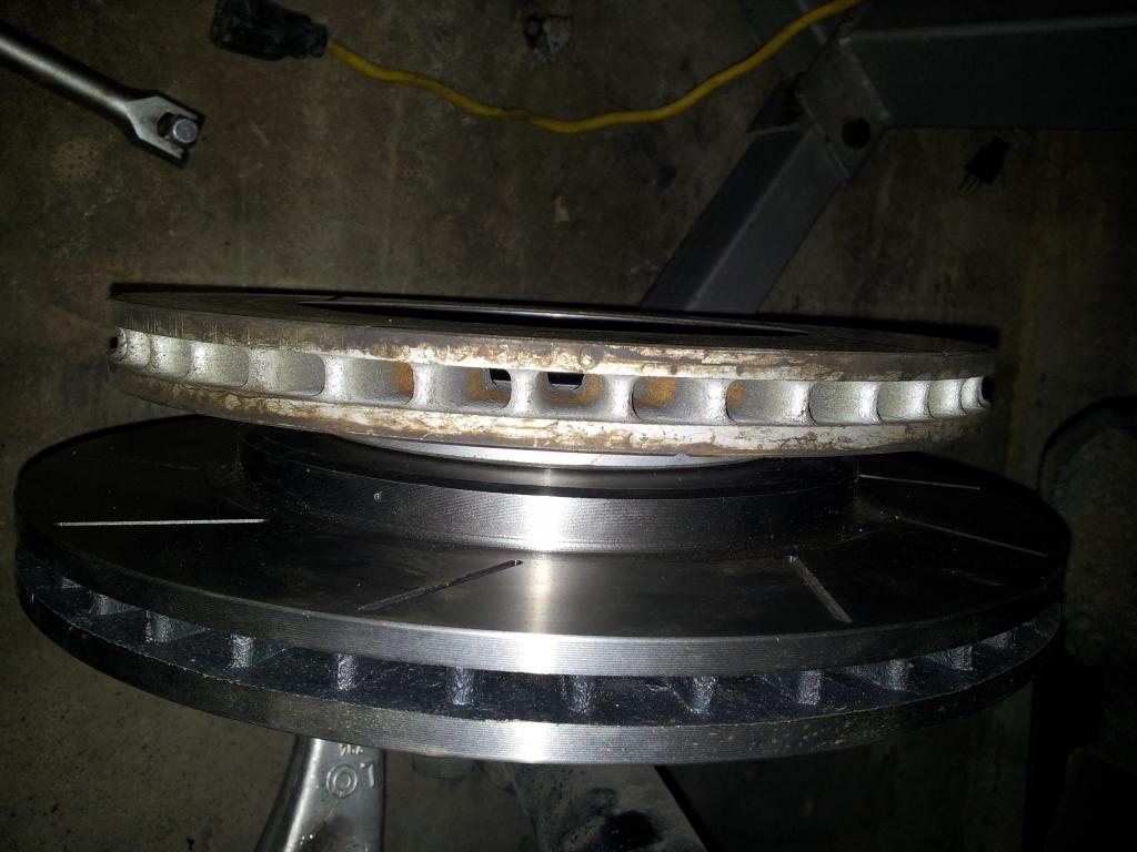

          thickness

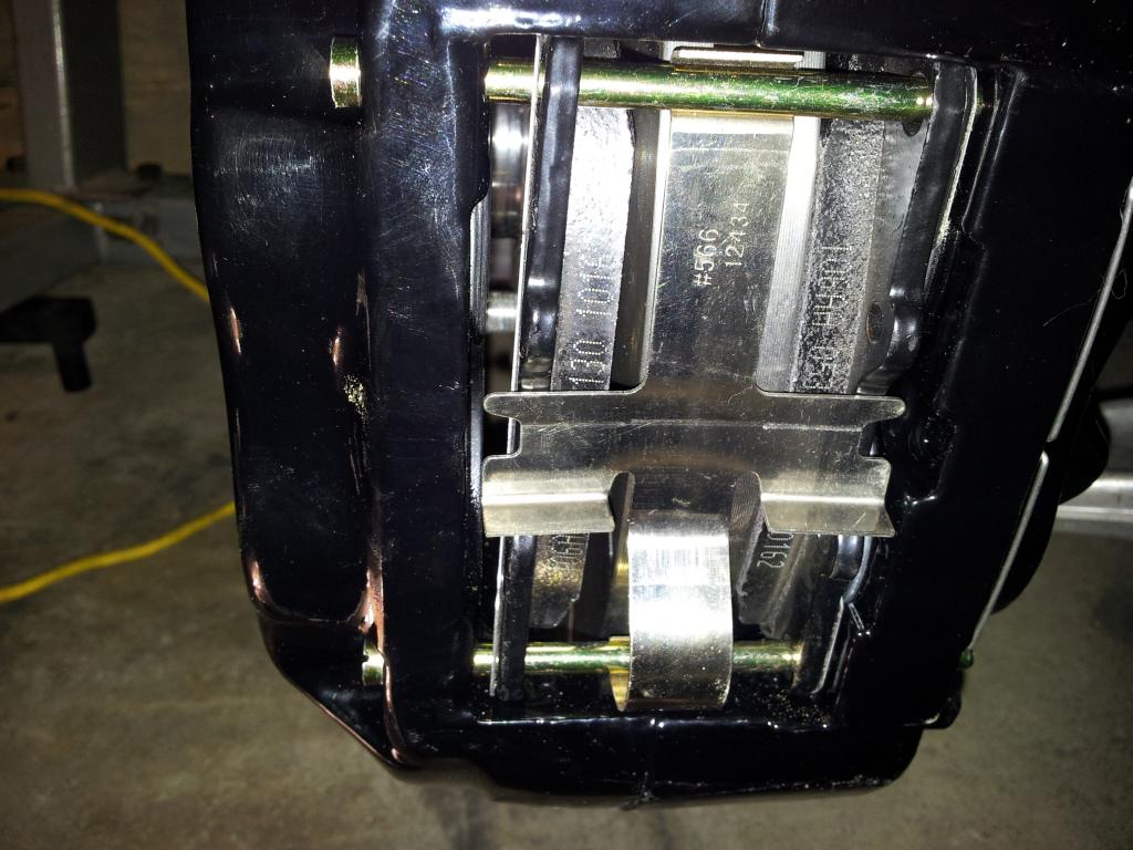

                      Which 3000 gto calipers are they. The short or tall versions? and info on the disc would be great too (mg or mini or?)
                      with regards to shimming are you going to make a plate for the back of the pads or something?

                            I've got it sorted as far as small details. If your thinkin of doin this swap p.m me and i can provide details or read first post.

                              nope. not tall enough.
