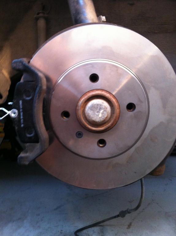

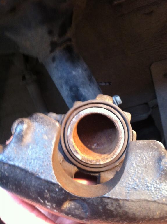

    So I bought new brake pads and rotors off of turnermotorsport but the brake pads won't fit. I have compressed the piston of the calipers and I have opened the brake fluid. I bolted the caliper bracket on, put the brake pads on the tried to fit the brake caliper over but it doesn't fit the pads properly. If there is anything I'm doing wrong I would sure love some help. Thanks

    Whats the part number on the pads? maybe they sent you the wrong ones. Check the shape compared to the old pads.
    And get a front picture of rotor and pads.

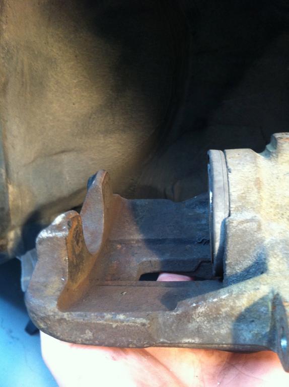

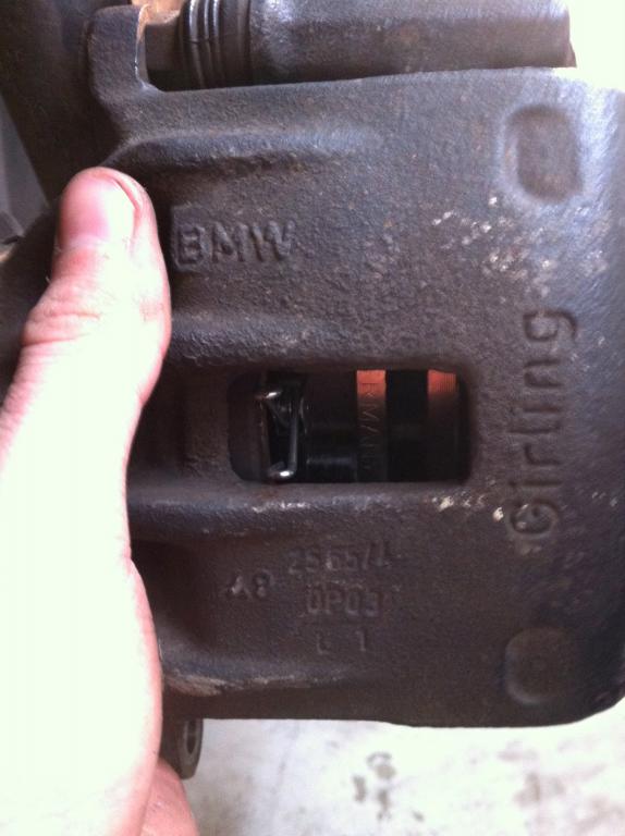

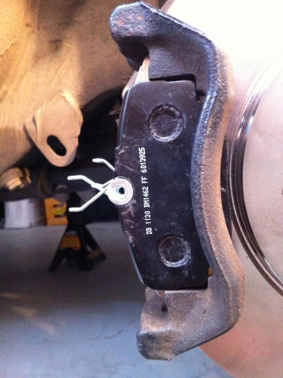

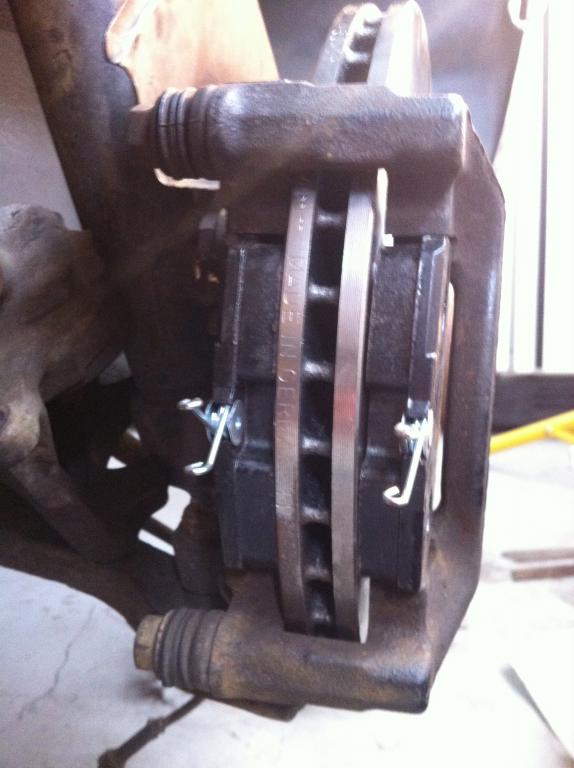

      Here are more pictures

        The new brake pads look identical to the old brake pads

          Originally posted by Delliott
          ... tried to fit the brake caliper over but it doesn't fit the pads properly.
          What do you mean by this?
          There are two anti rattle springs pushing against the caliper as you are trying to push it on. I prefer to assemble the caliper to the caliper carrier first and then install as a unit. This allows you to install one pad at a time. Also, your caliper piston will retract further than is shown in the pic.

            Also... did you remove and lubricate your caliper slides? Make sure they are moving freely so you can push them in enough to get the caliper lined up properly.

              Try retracting the piston further

                Thanks everyone for the help i got it done

                      The retaining spring needs to be spread out a little, this forces the pad down into to the bracket.
                      Then install the caliper.
                      See the spring should be pushing down here, but it isn't.
                            Did you get this "spring thing" straightened out? It will cause problems soon, if not now.
