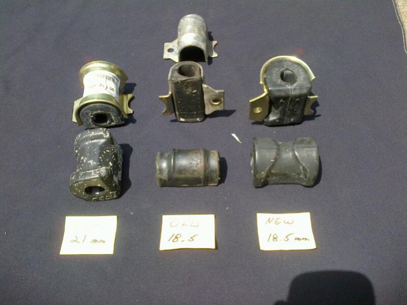

                    The sway bar bushing are just a pita. I had some trouble getting the correct sizes & shapes. Besides the different sway bar diameters, BMW changed the shape of most of them. Fortunately, all the new ones (even aftermarket) seem to be the same shape so just get new brackets (PN 31 35 1127 202..I pd $3.33@). Some bushings are split others have to be muscled on with soap & water so you may just want to remove the whole bar and have a 2nd pair of hands to put it back. Lube the bushing in the brackets and use a jack to "help" them in to place so you can get the bolts started.

                      Not sure which bushings or what you mean by "kit" but I tend to buy individual parts so I can control what brands I get. I have 3 sets of sway bar bushings (2 more to install) & 2 are OEM, 1 is aftermarket. I like the OEM ones (who doesn't) and my dealer gives me great pricing. getmwparts.com is very good for OEM. The sway bar brackets are only OEM so its all about price.
