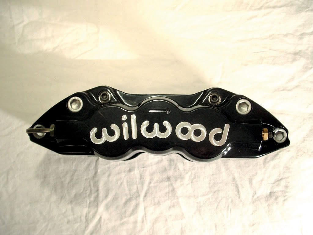

                      BTW If somebody is building a kit around 14" rotors , then there is no reason to go to StopTech or AP Racing calipers. Wilwood now makes the W6A (6 pots) and W4A (4 pots). They are huuuuge, have big pads and are not too costly.
                      One the left - W6A - Uses big pads (40% more surface than Superlite pads but 17mm thickness).
                      Center - Race SL6R - Uses thick 21mm pads
                      Right - SL6R-14" - Uses thinner 17mm pads
