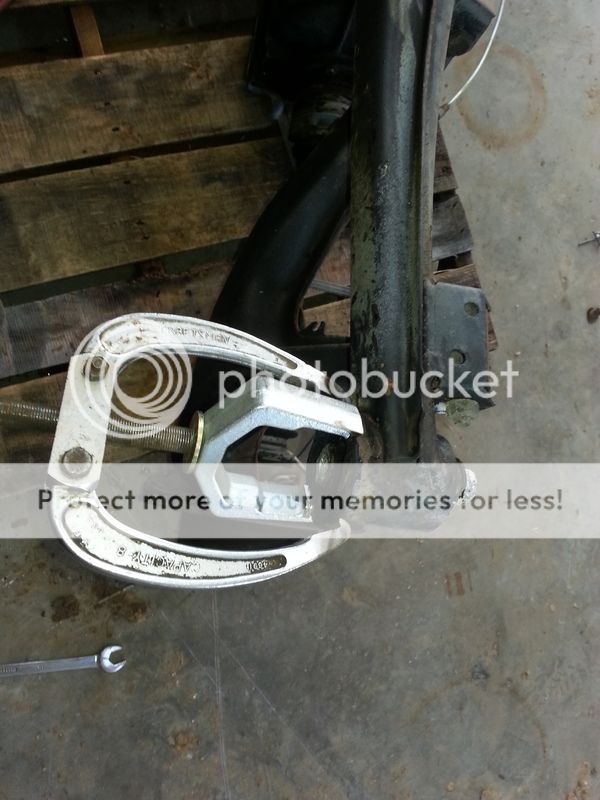

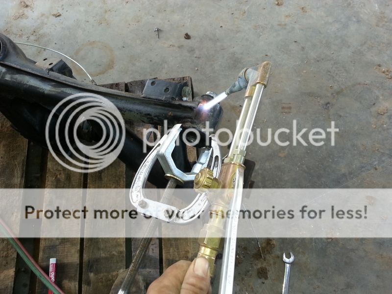

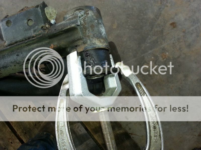

    yea thats good i just did mine today too i used a pitman arm puller
    and a two jaw puller put a little heat and came out quick

      pitman puller and a torch and 20 minutes later your done
