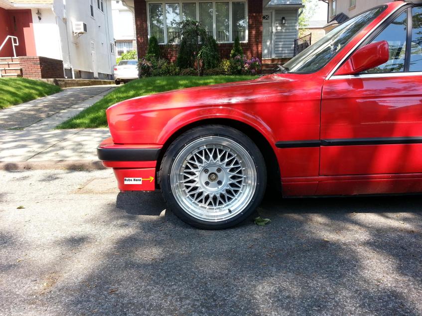

    Car handles very wheel but after swapping in the lollipops the front wheels sit more forward in the wheel well. On stock bottle caps there isn't too much of an issue with it, but on my ESMs the tire rubs on the metal bumper/valence.
    I was wondering if it was possible to swap in E30 M3 control arms into my non m3 front suspension since the Treehouse lollipops seem similar to M3 CABs
    Any other input on how to set the wheel back to the middle of the wheel well would be greatly appreciated.

                    Picture of rubbing point?

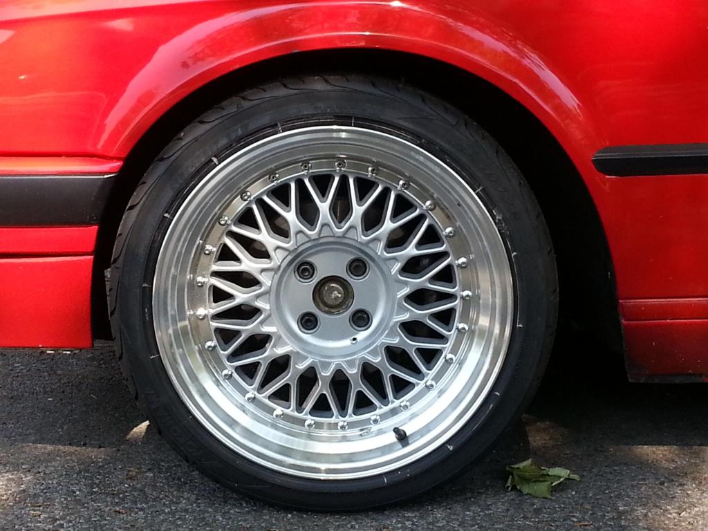

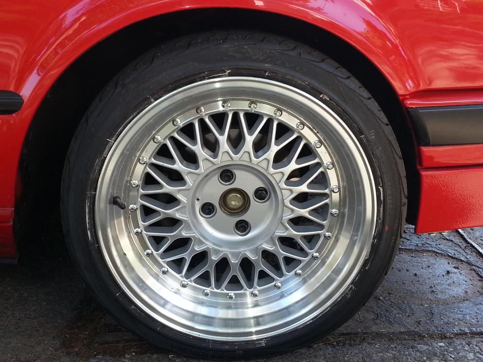

                          Pictures:

                            I would imagine you are not running an ET:20 offset wheel with that tire size. I believe the offset of my ESMs is placing a role in the rubbing because the stock bottlecaps which are relatively similar in size (there worn down, ESMs are brand new rubber) don't seem have any issues.
