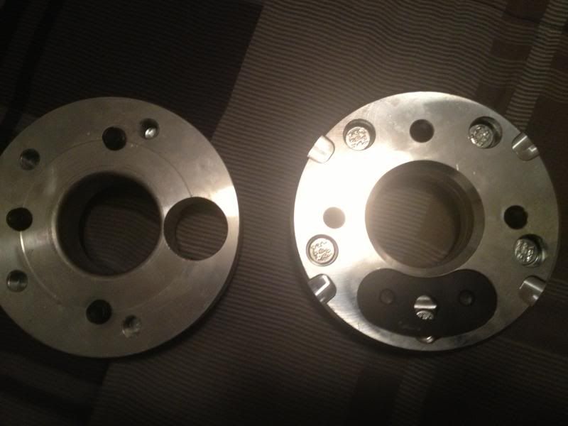

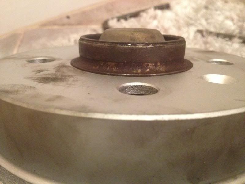

                          Ok so when I got home I forgot that I had some front struts lying around, so I test fit the rotors again.
                          The center bore is definitely shaved 1mm.
                          Mounted with Adaptec adapters there is >1mm gap between the rotor and the adapter.
                          Then I remembered my brother has 8380 adapters lying around and they have a tapered center bore. Adaptec on the left, 8380 on the right.
                          8380 adapters mounted have <1mm gap between the adapter and the rotor. I would feel alot better mounting these with the Corrado rotors.
                          I am going to contact Adaptec and see if they can taper the center bore to fit the E30 better. Need to get a little thicker adapters for my stance anyways.
                          • golde30
                            • 11464
                            Shouldn't even be .5mm between rotor and adapters, with the adapter bolted onto the hub, it should be putting 80ft/lbs against the rotor surface against the hub.
                            IG: @Baye30
                            • Silver Surfer
                              • Aug 2012
                              • 229
                              Thanks golde30, I'm gonna see if I can track down a 1mm rotor spacer then. The adapters were put on very tight to test fitment on rotor.
