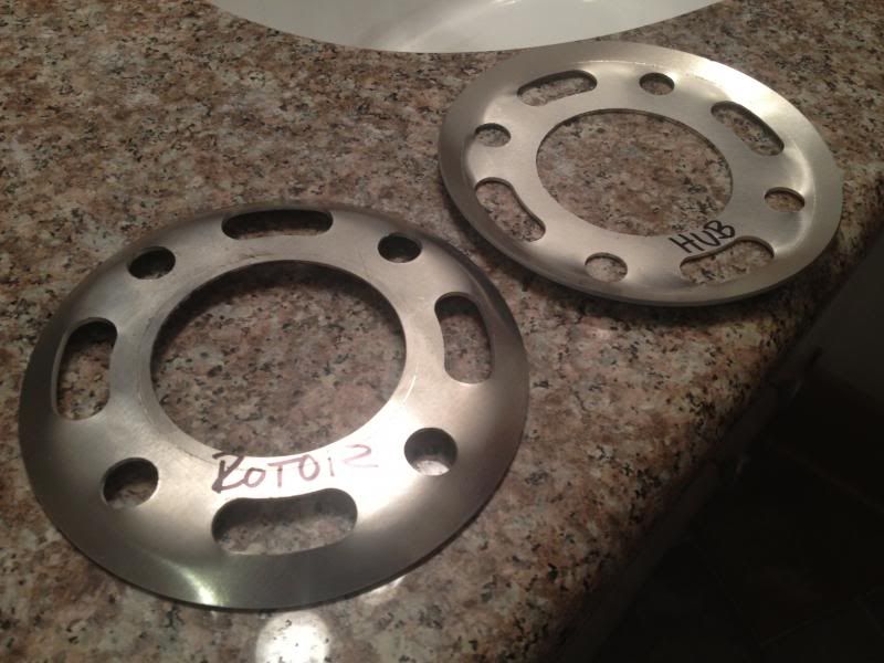

    I just ordered 1.5mm rotor spacers that mount on the rotor hat from Massive. Cost $50 cad shipped. Hopefully this works out, I will post pics of them when I receive them.

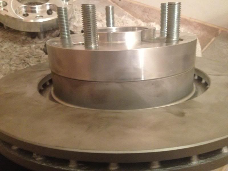

      I received the massive rotor hat spacers yesterday in the mail, they got here quick from Canada! They fit the hub like a glove.

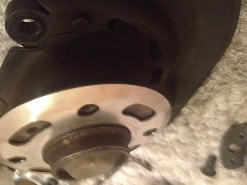

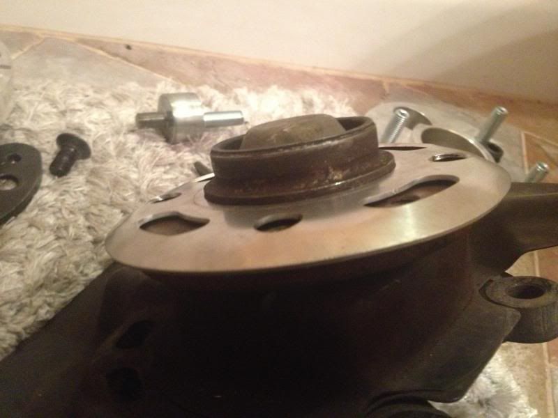

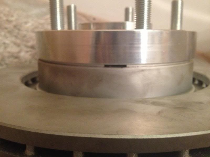

      Then I test fit the rotor and the spacer seems too big to use with the corrado rotors. After inspecting the rear of the rotor I realize that it's tapered on the edges. I tired to mount the adaptec adapters to get them to bend the shape of the rotor. The adaptec adapters wouldn't reach the lug holes on the hub. Brought out the 8380 adapters and they were able to mount and bend the spacers. Then I test fit the adpatec adapters and they work now as well.
      These should work now! Can't wait to mount the brakes on my next day off.

            ...you put the spacer BEHIND the rotor?
            84 325e - 91 325i - 92 318 touring - 91 Trans Am - 01 S4 avant - 03 S-type R - 96 F350 - 15 SS - 84 Biturbo - 91 Defender
            • Silver Surfer
              • Aug 2012
              • 229
              Damn it, should put them in between the rotor and the adapter...
              They didn't fit properly once mounted this way. Rotors would hit the calipers and would not spin properly.
              Makes sense why it's called a rotor hat.
