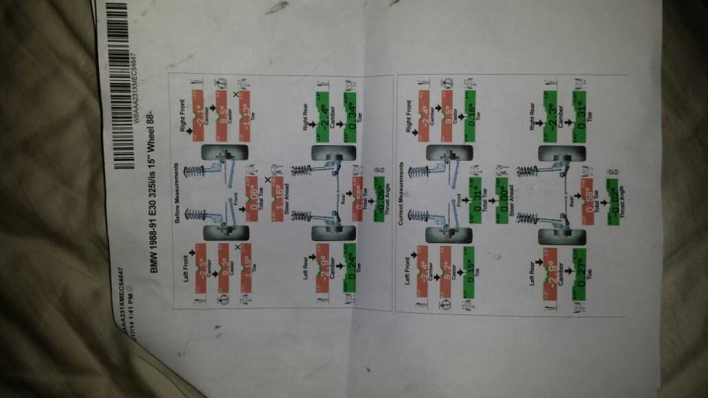

                              Everything turned out great, car handles like a dream, going to get the rear busing in when I have time. Thanks again for the help everyone.
