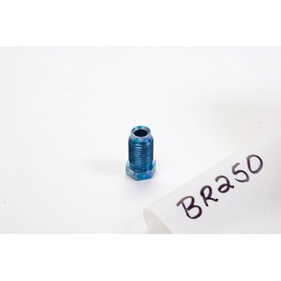

This is what I used:
Luckily there is a case of these things.
