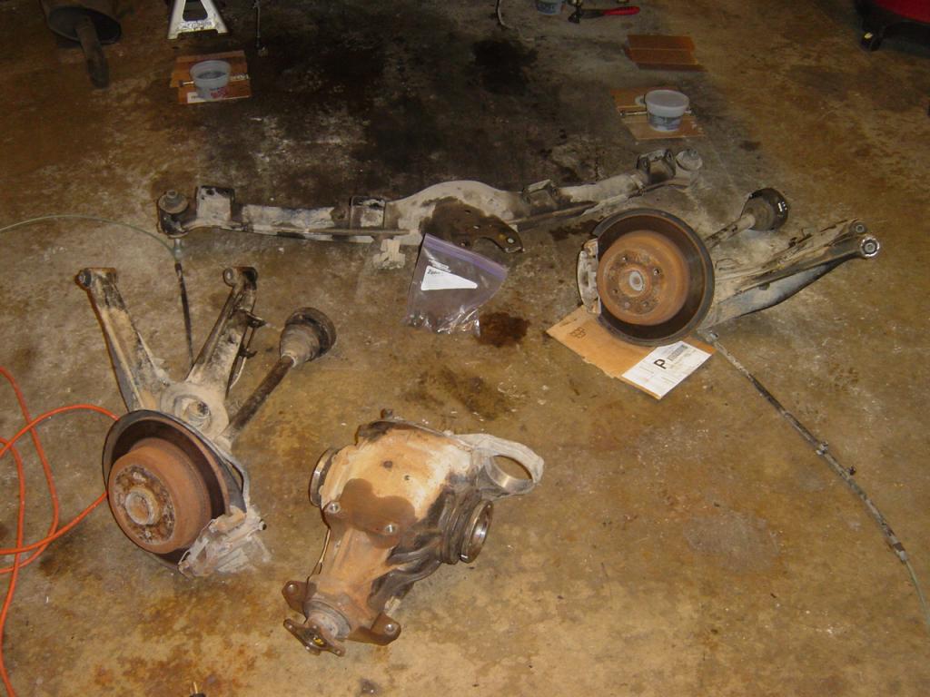

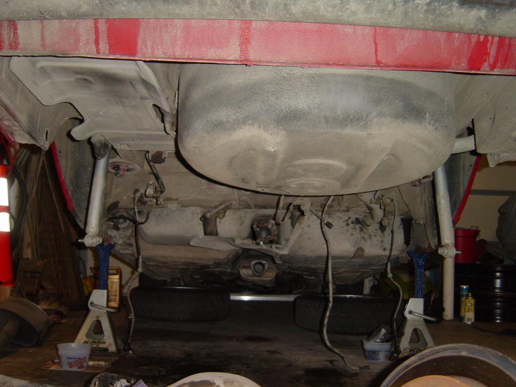

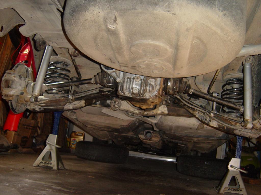

              I got the subframe out, axles off, trailing arms off, most bushings out. Was trying the slick FredK simple way to get the subframe bushings out but it just wasn't working, so I pulled the exhaust, dropped the subframe, and I'm doing it all on the floor.
              Getting it all back together and lined up and back in place seems like it'll be quite a chore. Especially lining up the driveshaft flange.

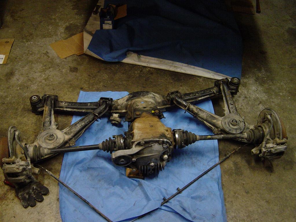

                  Empty..
                  Back together with all new bushings...now to teeter totter it on a jack....

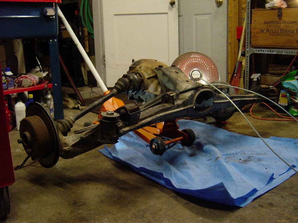

                  Took the bushings out last night late, dropped off pieces at a shop with a big press this morning, he had them ready by 5.
                  Those sway bar links are a pain to get back on - force doesn't work. I tried the boiling water trick and some dish soap and they popped right on!
