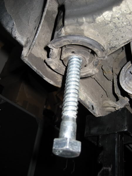

    Rear sub-frame bushing trick not working
    I am trying FredK's slick method for popping the sub-frame bushing out from above by pounding on the pointy end of a 5/8 lag bolt installed from below.
    It's not working. Everything is loose. The subframe splined bolts popped right out, no corrosion. Subframe wants to drop - I have a jack with a block of wood under the center to support it. Car is on jack stands at the rear jack points.
    I've soaked everything with PB. I've been banging on a 3/8 extension from inside the back seat with a dead blow hammer.
    Not budging. Could the whole subframe be rocking instead of the bushing letting go? Does the sub-frame have to be on it's own jack stands?

    Sometimes, this bit sticking out will get stuck in the chassis. Not sure how to fix it (employed my dad's help on mine), but I'm thinking this is likely your issue, unless I misread something. If I'm remembering right, my dad ended up separating the the sleeve that goes into the sub frame from the piece the bolt goes through by drilling (?) out the rubber. I'll ask later and see if he remembers.

      Fred said he gave it a couple of whacks and it came right out. Mine isn't corroded at all and it's not budging - no movement at all.
      I've started pulling out the whole sub-frame, as I'm changing the diff bushing as well as TA and sway bar bushings.

        Sub-frame and rear suspension are all out. Sub-frame bushings dropped right out of the car - nothing stuck.

            i had an issue that sounds pretty similar to OP's - i ended up having to thread the bushing sleeve for a 16mm bolt (pretty much the same setup as above) but used an air hammer from above. it was the biggest baddest air hammer that snap on makes and it still took like 30 seconds of air hammering to get that damn sleeve loose out of the chassis

              I am working on my subframe right now took it off yesterday. It was stuck pretty bad and seeing how i have a cabrio working from the top down was gonna be a pain. I used a slegde and gave the sub a few good kicks and ended up braking the metal bushing sleeve in half so i had about a half inch of sleeve stuck in the chassis holes. If that happens to you i recommend drilling out the sleeve, its soft metal so drills easy.

                Originally posted by BMWManiac
                So was something stuck? What was keeping your subframe in there?
                I think the "pins" or sleeves on the subframe were already completely loose - no corrosion. So I was pounding on a subframe that was supported in the center on the jack, and was just flexing / rocking back and forth when I pounded down.
                If the subframe is on a set of jack stands, you could pound on the lag bolt and push the bushing out. My method had nothing pushing up to counter the pounding down.
                I had a shop press the old ones out and new ones in. He had a 30 ton press. Worth it.

                        Same thing happened to me. I ended up cutting into the bushing a bunch of times with my Dremel to weaken it, then was able to get a screwdriver in there and break it apart and get it out in chunks:

                            ^^^^is that the metal sleeve stuck in there?
                            Is that the only part that goes into anything? I figured since the bushing sticks out the subframe itself that the bushing head went into some kind of recess, but I guess it is just the metal part of the bushing and that is what typically gets stuck?

                              Yeah, the metal center sleeve of the bushing fits up into a cylindrical structural steel recess in the body. Aluminum and steel not playing nice together, corrosion, and it's stuck up in there. Mine just fell right out - lucky.
