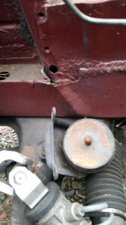

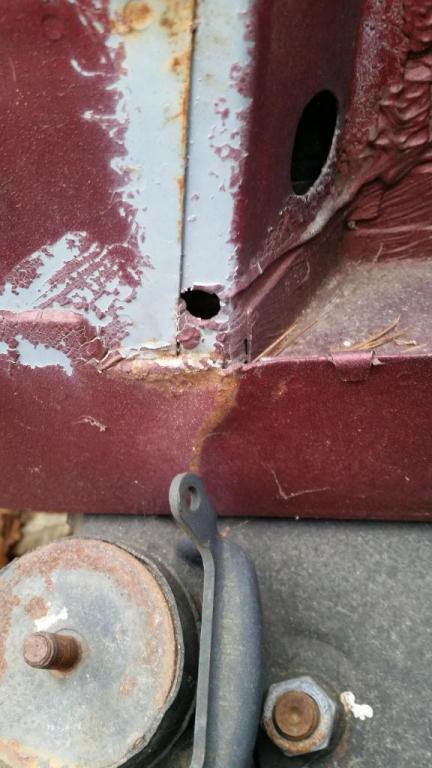

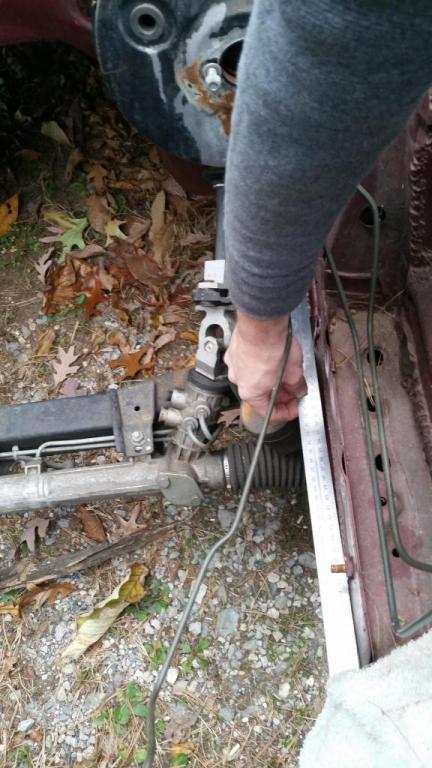

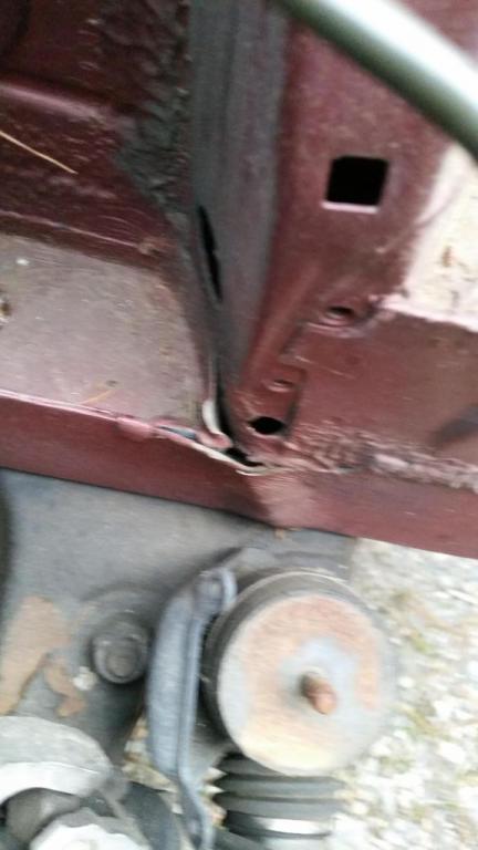

      just wondering how did you figure that it's pushed back? Any signs of the accident ?
      Look for something like in these pics....1/4 off would definitely leave a mark..Pictures are curtesy of Scoobiedoo2029
