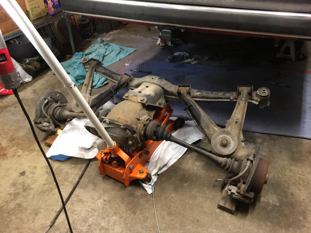

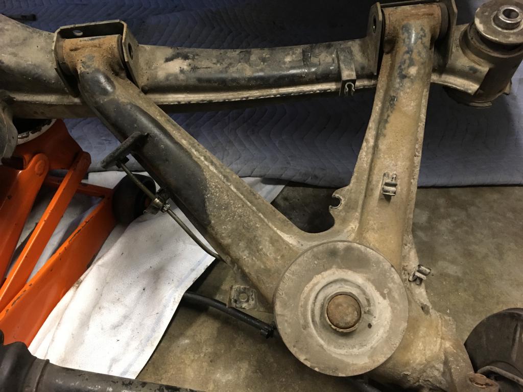

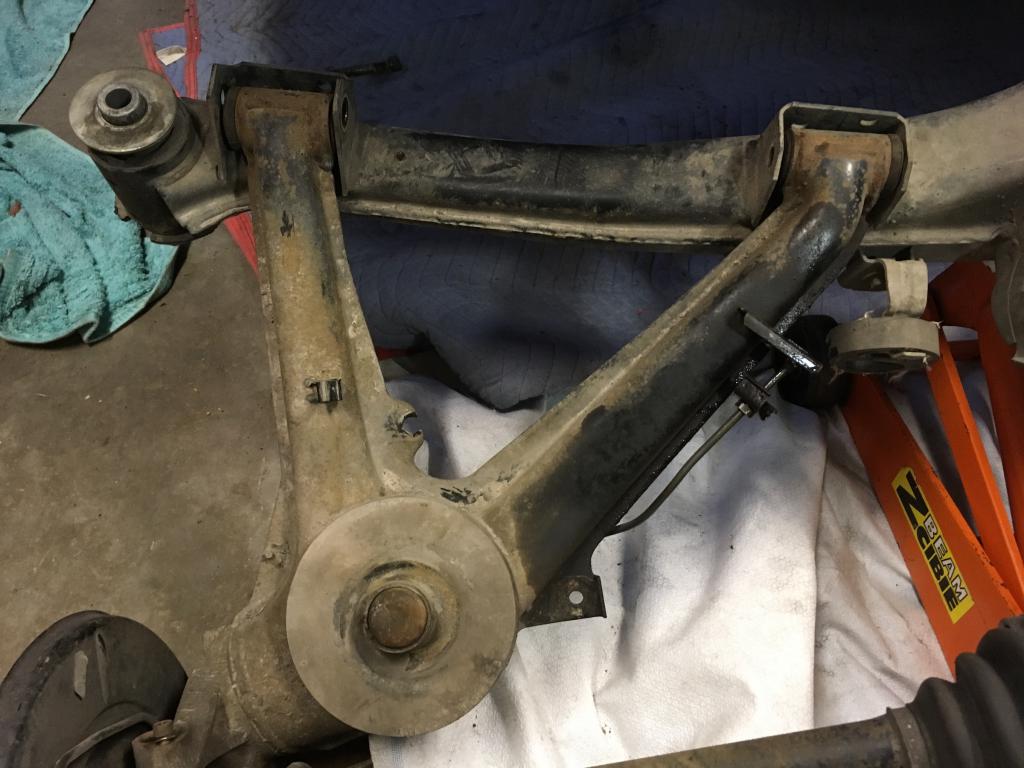

        We pulled the subframe to weld on IE adjustable TA tabs. I don't see any bends or cracks on the TA's. Don't have the right dowel yet, but eyeballing through the TA holes with a light, they look to line up fine.

          you won't be able to spot a bent TA by eyeballing the TAB holes. They bend at the big cast thing that holds the bearing.
