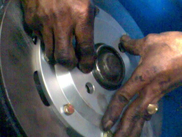

Sorry for the long delay. I have been really busy. I was going to put the brakes in myself but it turns out that the mechanic that is doing the engine swap wanted to do it for free. He was interested in seeing how the brakes worked out too! So I dropped them off last week and he started the install today. We ran into some problems already! The hats Lee has sent doesn't fit the hubs! Damn it! So right now I am waiting for a response from Lee......
I am sure it is a minor hiccup and Lee will fix this soon......Comment
Wow. I emailed Lee the situation and he responded in no time. He offered to replace the hats with the proper fitting ones, no charge and including all the shipping within 72 hours. Damn. Only if my mechanic was this fast!
Thanks Lee!Comment

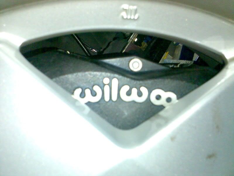

So I got the car back with the brakes installed. There were a few hiccups but nothing that Lee couldn't help us with. All in all the brakes went in really smoothly, my mechanic was a little upset with the way he had to grind and remove tabs to install the brakes but it all fit eventually. It was a really tight fit, I ended up using 5mm spacers.
One issue I am having with the spacers is the car shakes at 100 km/hr. I think it has to due with the wheels being no longer hub-centric because the spacers take up the hub thickness and the wheel no longer aligns with the hub. Is there a solution to this?
As for the performance, we had some issues with bleeding the brakes, probably due the lines being completely drained. But once that was up and running, they worked great. All in all I am really pleased with the way the installation went. The brake response is really smooth and unlike my stock rotors, the Wilwood didn't fade noticably under repeated heavy braking. Lee was really helpful, he replied to every email promptly and had an answer for every question I posed. I would recommend anyone to upgrade to Massive!

Thanks very much for the good word. It does happen that from time to time there are glitches in the installation, but I will always be prompt to reply. As some of you may remember, I (and a few customers) were surprised by the discrepency in hub designs between SKF and FAG (even FAG is not consistent, some hubs have a recess, some don't). I hope I have resolved the problem to every customer's satisfaction. It was the only glitch is several years.
When installed and properly adjusted, the calipers should be perfectly centered with the rotor (it may be off, by a max of 0,2mm). The height of pad can be adjusted to fit your specific pad. Not all suppliers are indeed following Wilwood's specs. By exemple, Performance Friction pads are missing about 2,5mm of pad compound on the outer perimeter. Which is why the range of adjustement on the bracket is 3mm.
