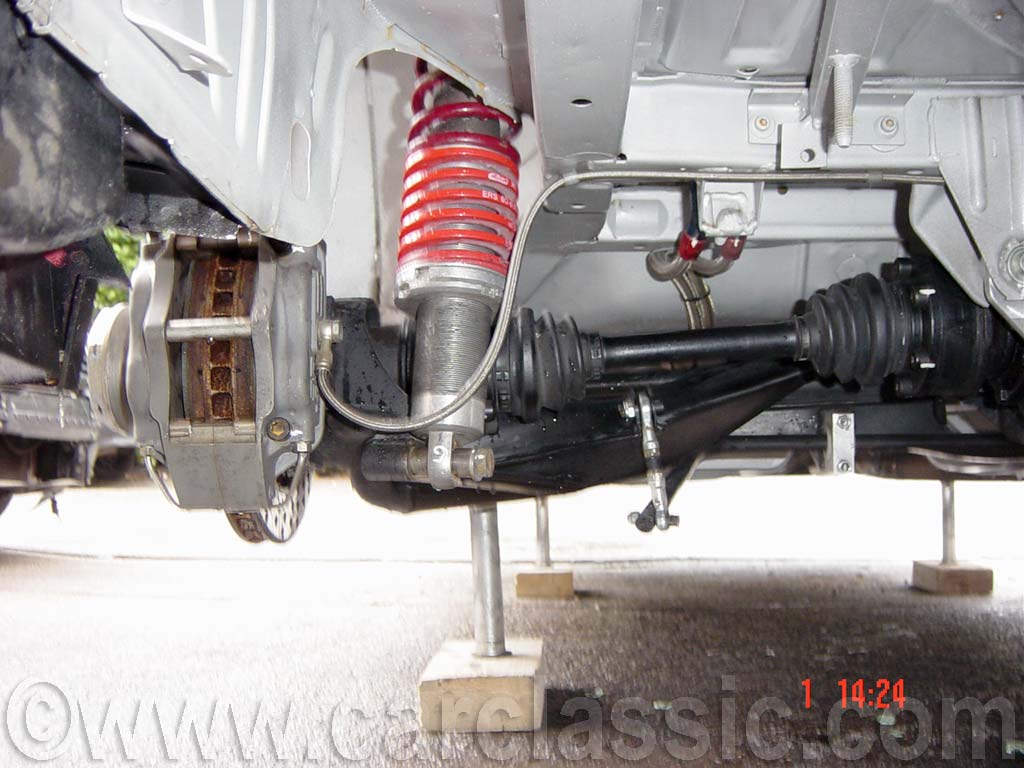

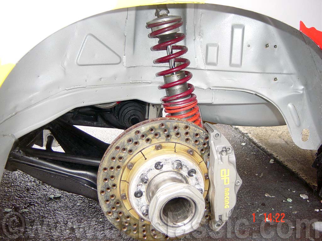

Found some pics, hoping its not a repost, but, whats involved?
Coilover Setup...
Originally posted by Farbin Kaiber View PostNobody?
Its pretty obvious that the cut/ground off the original sjock mounting boss/ear and welded one to the top of the hub area .
Then bolted on a readily available true coil-over shock assembly .
And I cold see them maybe selling the shock/spring/mount coil-over set-up but they will NEVER produce and sell those modified rear trailing arms .
PS : Also others have been mounting the true coil-over shocks on the original location for many years .
All you got to do to the rear is re-enforce the rear shock towers for it to work.My 2.9L Build!
