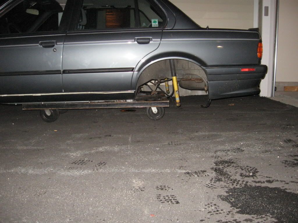

    I'm working on a clean, fairly rust free 90 325i, changing subframe bushings, trailing arm bushings, and wheel bearings. I've dropped 8+ subframes in these cars, and not once have I run into a problem. Murphy's law came around and bit me on this one - the subframe bushing shafts are both broken inside the body.
    How do I get these out? I want to avoid having to tow it to my dealership on a body dolly to use air tools or something to get it out, but I'm at a loss as to what my other options might be.
    Thoughts? :)

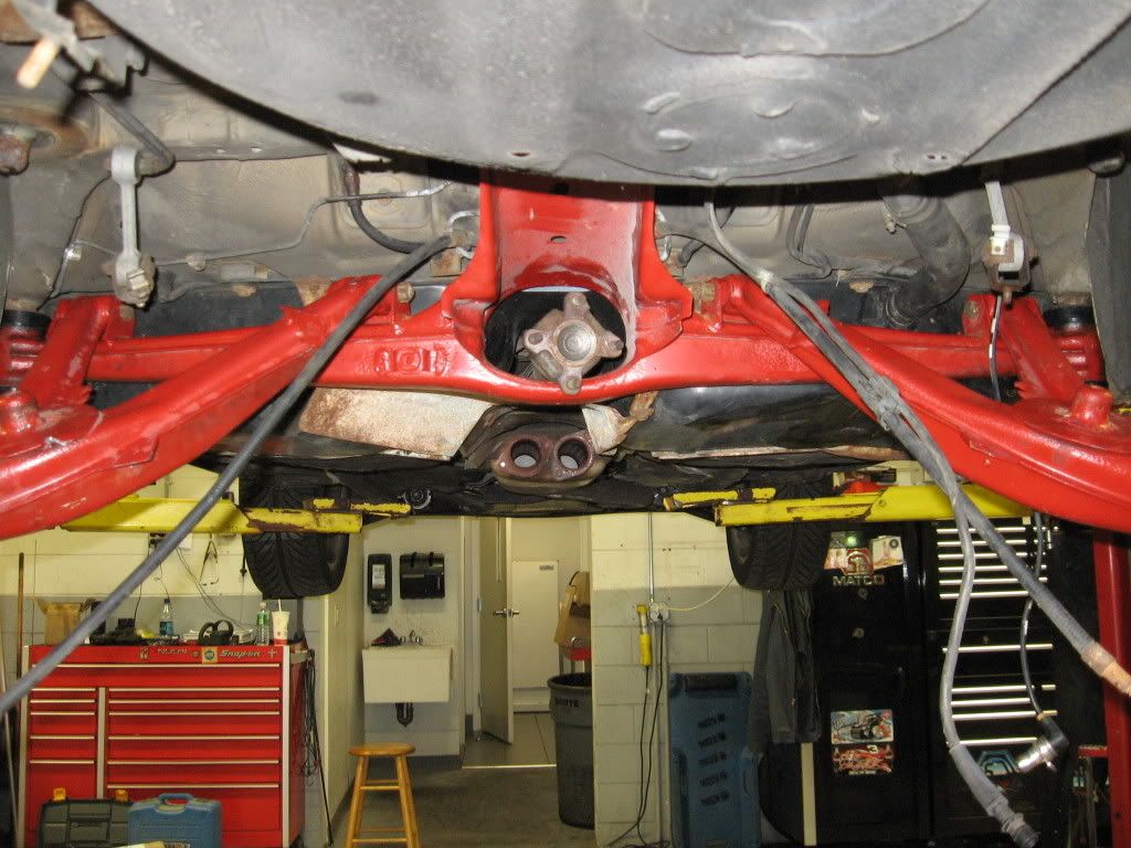

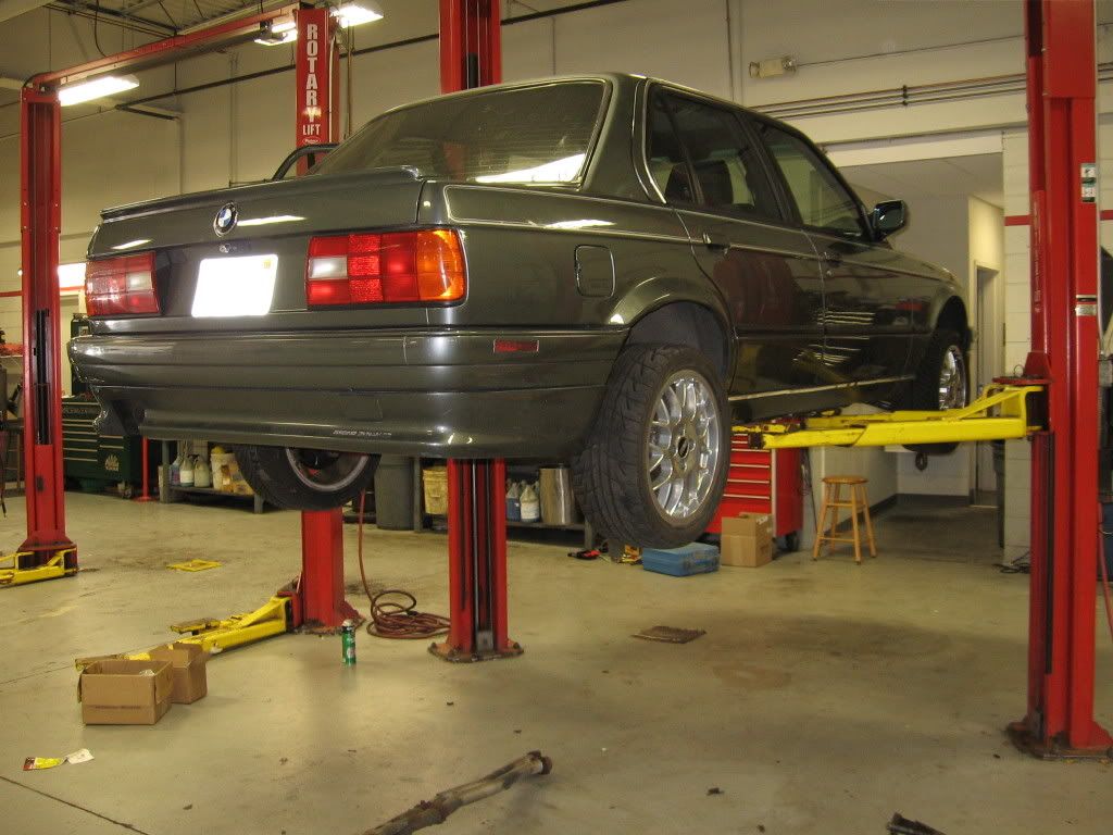

        If all else fails...
        ...find a body dolly and trailer it to a well lit shop with a lift, air tools, and a clean big area to work in.

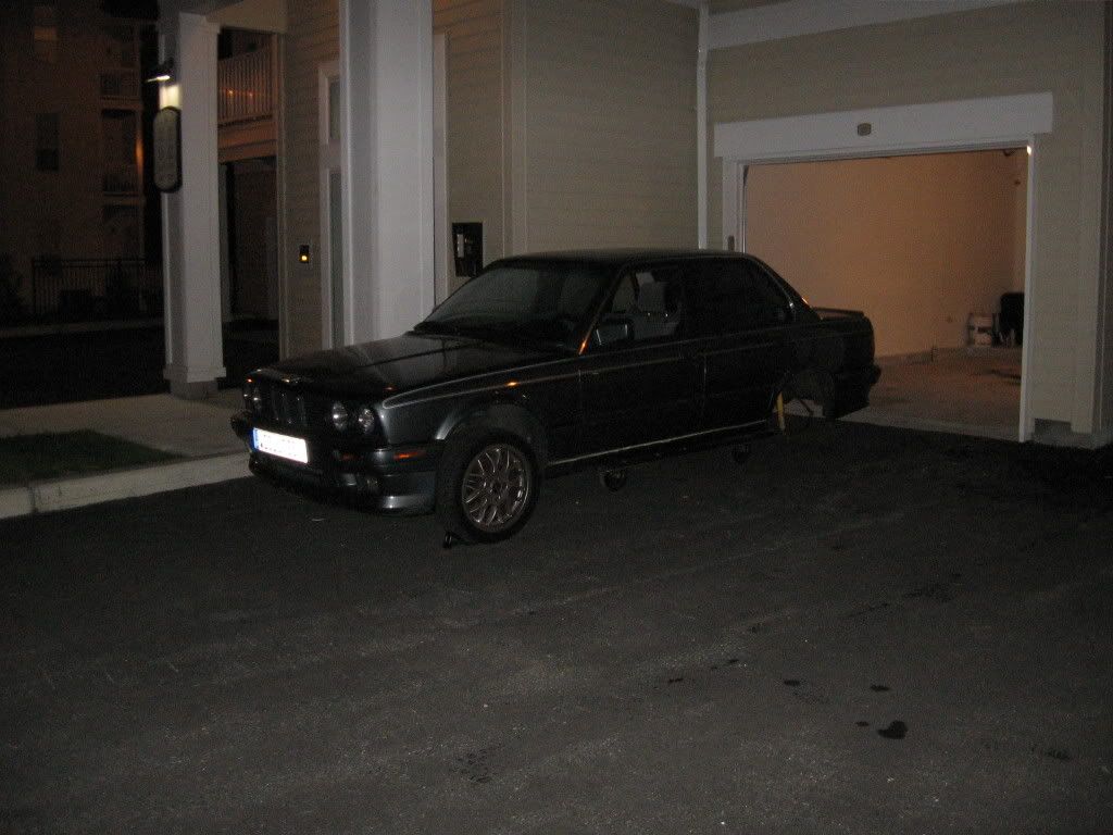

        Car out of my garage, on the body dolly:

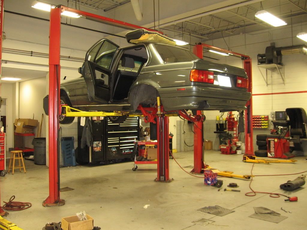

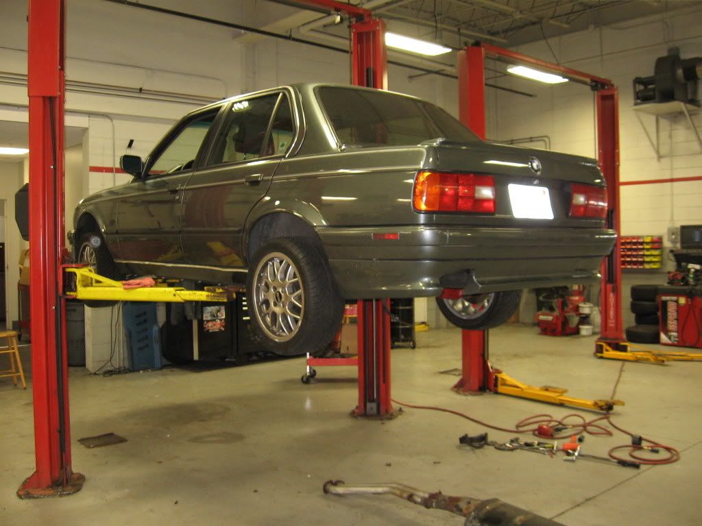

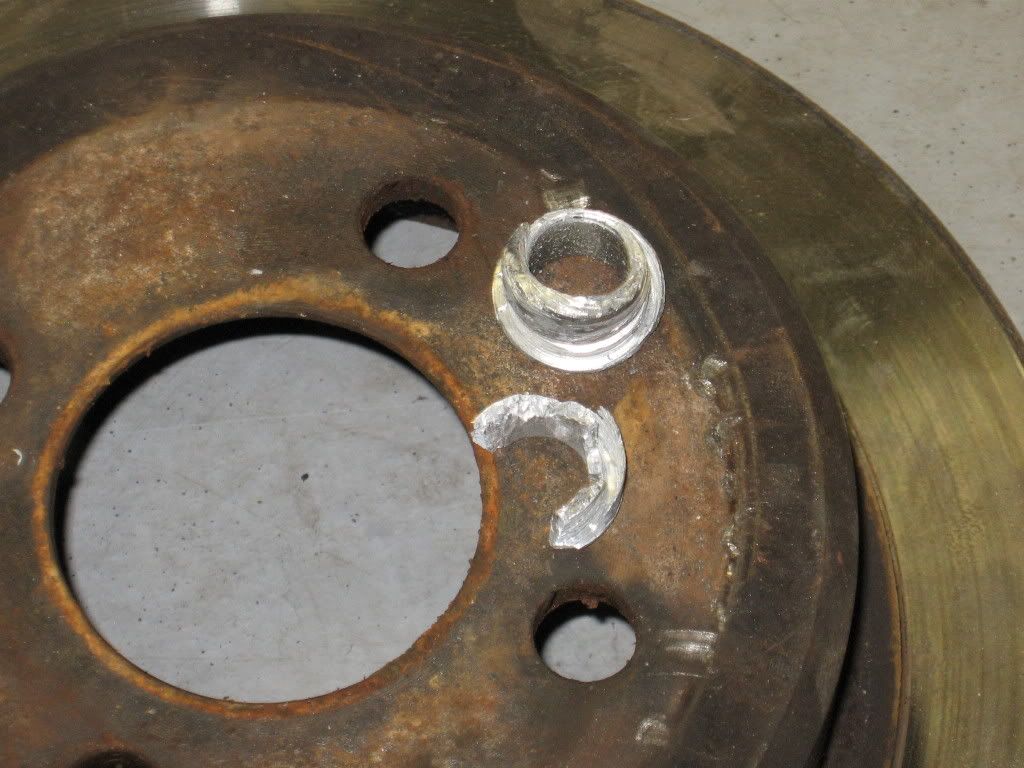

        Finally got it in the air and shed some new light on the situation. The solution: use a holesaw bit about the size of the shaft, start drilling and approximately 15 seconds per side have the remnants out.

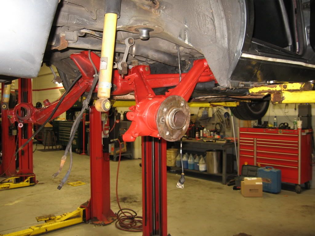

        Here's what's left of the cursed bushing shafts:
        Once those were out, it was smooth sailing:

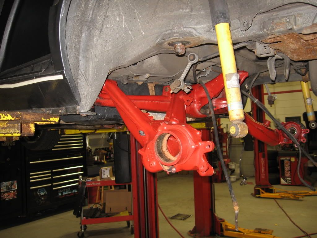

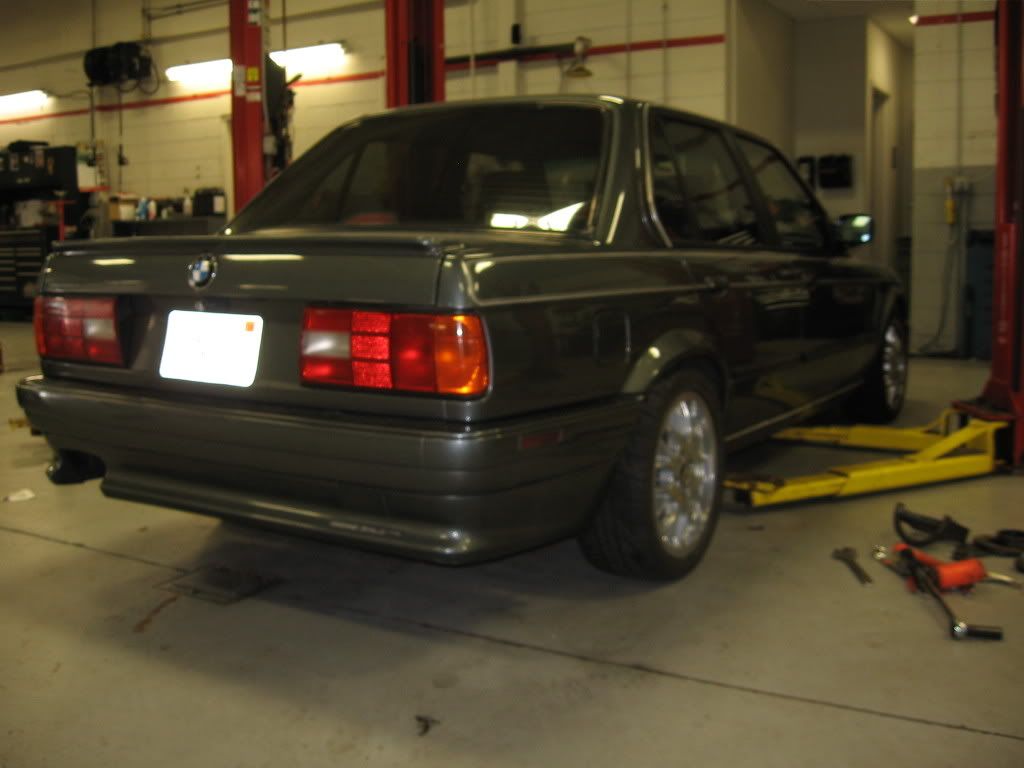

        And here's where I got to...
        To add - SS lines, brake rotor backing plates, springs, etc. This will be a nice ride when it's all cleaned up! ;)

          Small drill bit, drill halfway around, then put a centerpunch in the holes, and give them a few wacks, the alu ring will fly apart. Works for me everytime.

            Snap On cutsall. Three "cuts" and they tap out with a chiesel. Did it but can not find pics.

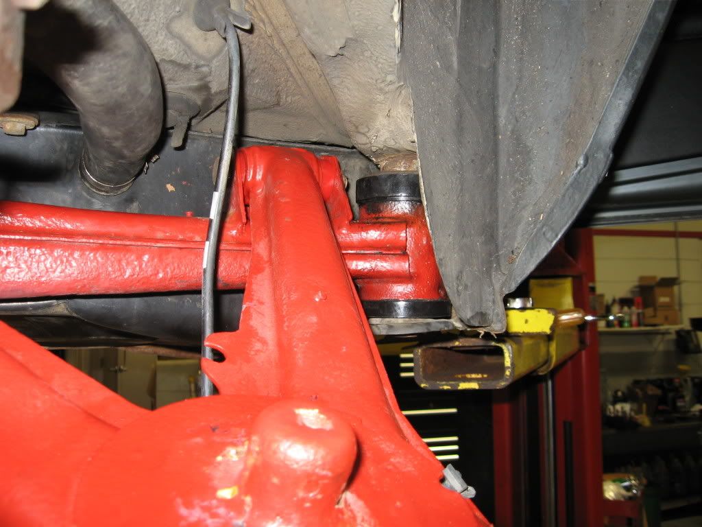

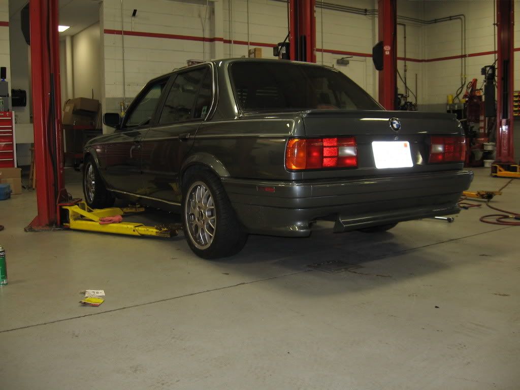

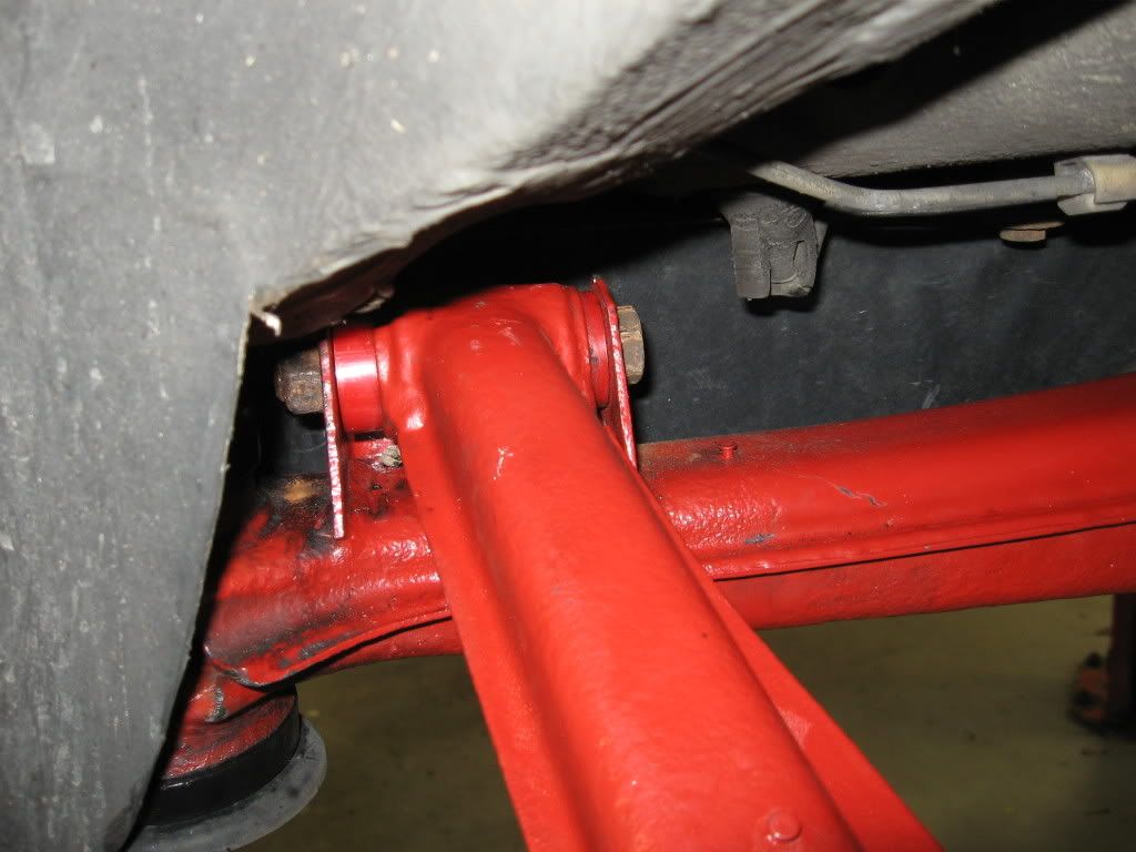

              More pics of the project:

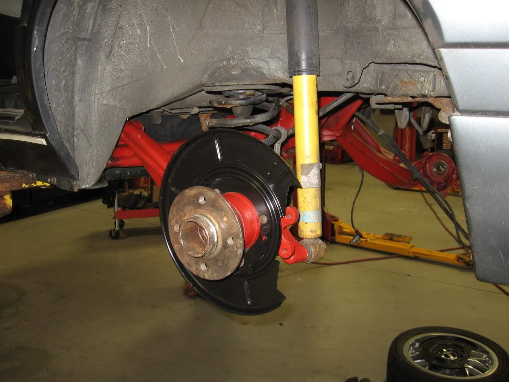

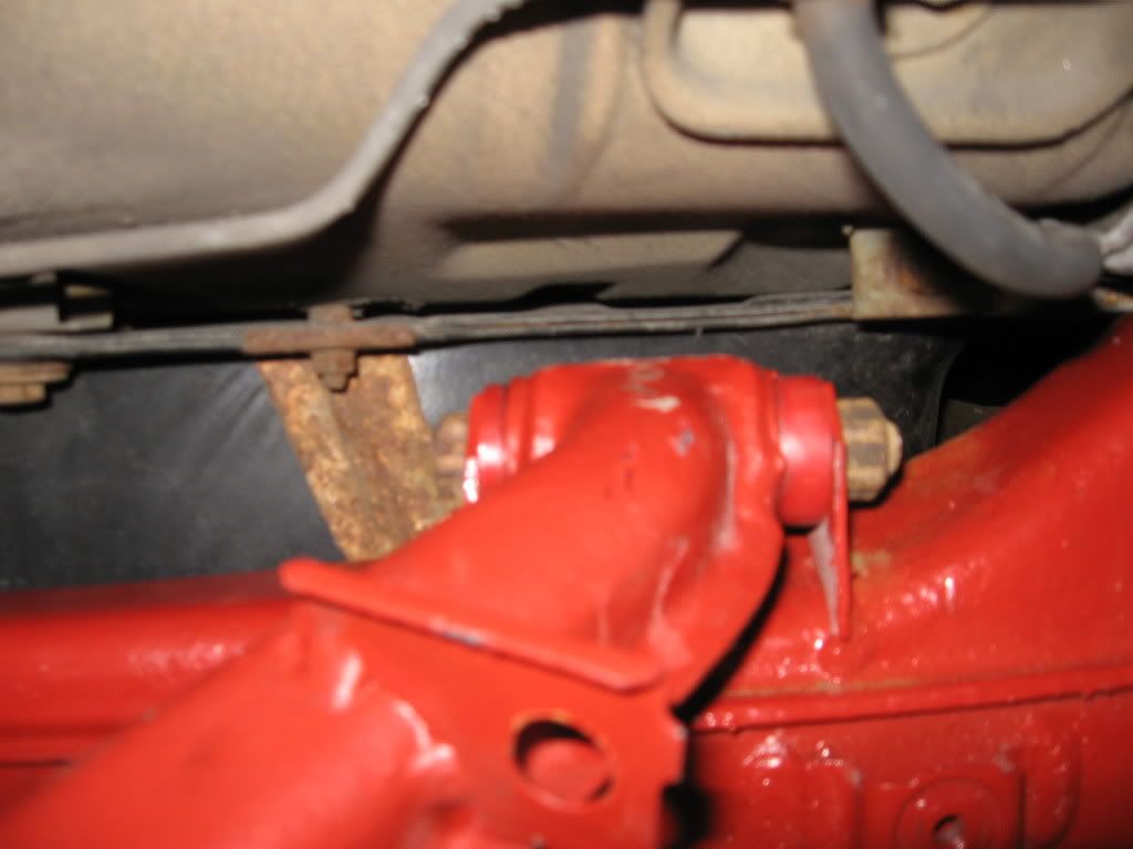

              Backing plates were trashed, luckily I had new ones for my own car, so I used them on his:
              Driver's side together again, less brakes:
              Closeups of the AKG bushings - fit like a glove, I won't even bother trying another company!

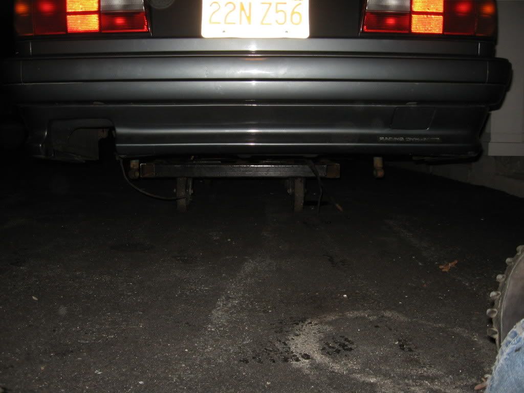

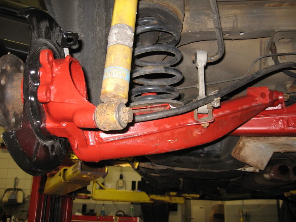

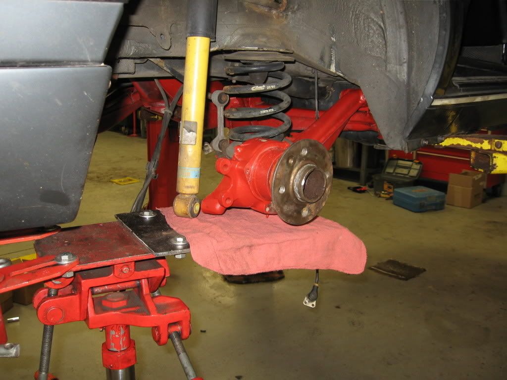

              Passenger side - I stupidly put the hub in before installing the backing plate, so I have to press the bearing and hub out and install it before pressing it all back in:
              The fuel tank damage...stupid tow truck!

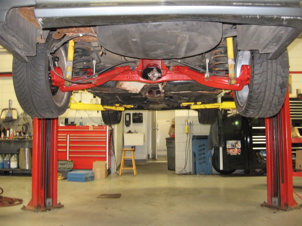

              Wheels back on, ready to roll out of the shop so it's out of the way for Monday:
              rear passenger wheel now pointing in the right direction :)
