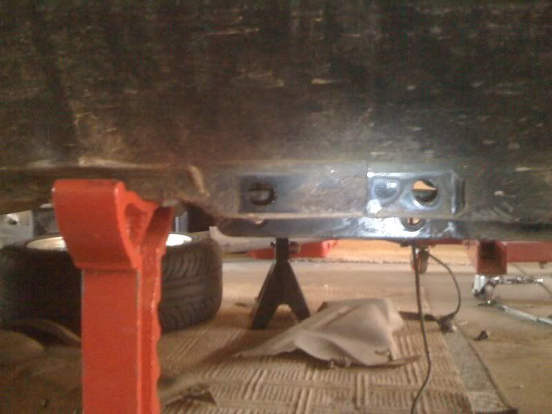

    So I pressed in my bushings today (pic 1,2). I went to install the subframe, but it appears the inner aluminum sleeve doesn't want to go all the way in (pics 3,4,5). Did i do this wrong? Or do I need to modify the sleeve?

    so i went an repulled the frame, made some adjustments, same problem. WTF!

      Pull the aluminum sleeve out and make sure it goes up into the hole. Put them both up there, if they will stay, Then put the subframe up in place.

        Is theirs a 2 or 1 part sleeve?

          3 piece. The bushing itself it two pieces, top and bottom, then the aluminum sleeve.
          i thought about that but didn't want to completely drop the frame again. i'll attempt and report back. thank you sir.

            Okay, PITA but it worked Pierced. Thanks. Now does anyone know the torque spec?
