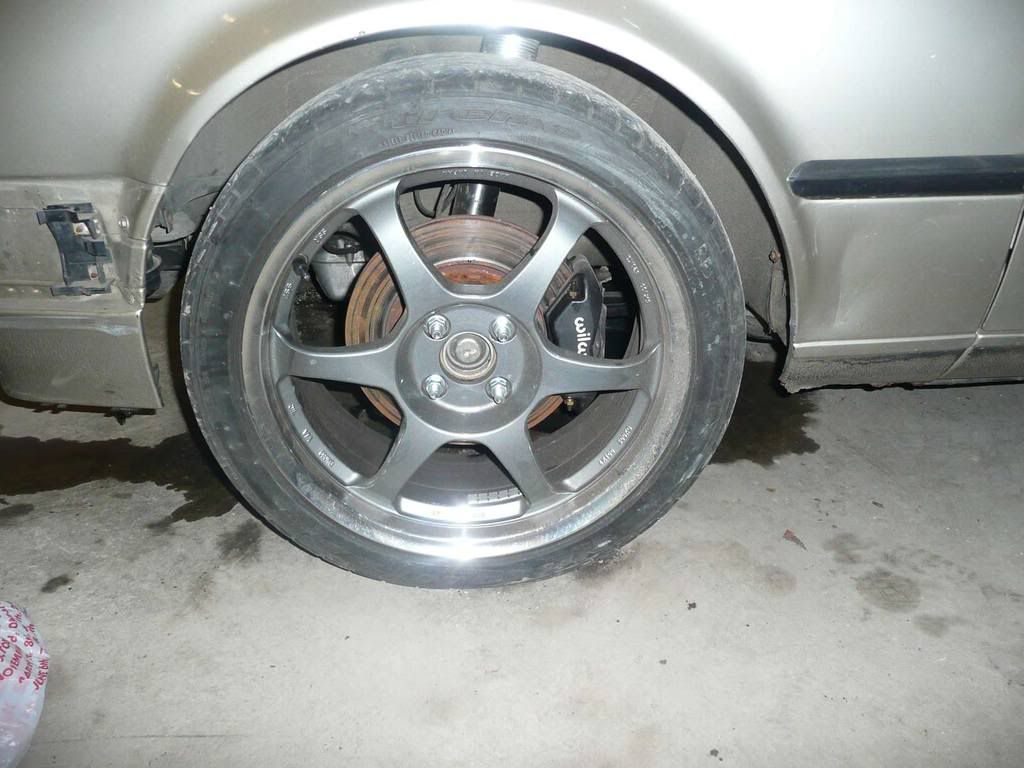

    I don't have the same exact wilwoods but that's basically what I have in my turbo project car that I haven't touched in a year.
    corrado rotors still look dinky in 17's. On these the hub was turned down as you suggested so stock rotors can be used.
    Gimme a ring sunday if you want to come grab an upright for mock up.
