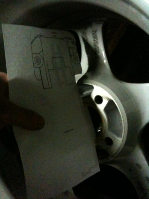

    Well not quite! I cut out the template again with 3mm measured as a spacer.
    Still not quite enough. Would probally need almost 7mm to clear.
    I didnt snap a pic of the template fitment inside the wheel, but it basically looks the same as above.
    Heres a couple pics to show im trying to be accurate.
    Then I out the wheels on the car! Looks alot better in person.

  • Brian D
    replied
    Well, that's disappointing. Thanks for the pictures, I'll continue my wheel search. I already have most of the components for the 300mm front and rear kits, and a street set of wheels that will fit, so I can't help with the 332 kit.
    Thanks again for measuring and posting the results!

  • qbuilt
    replied
    [ATTACH]24288[/ATTACH]
    [ATTACH]24289[/ATTACH]
    [ATTACH]24290[/ATTACH]
    [ATTACH]24291[/ATTACH]
    Sorry, poor quality pics, but you get the idea. I also am a dumbass, the 21mm kit does have more clearance. About a cm at most. I think it would fit, maybe just a little filing of the caliper would be needed.
    However, if Lee were to make a 332mm kit, this would most likely move the caliper up approx 16mm which I think would make the fitment of the bigger rotor possible.
    If anyone would be interested in a 332mm kit for 4 bolt e30's to fit under the 17's please let me know. I currently have a 310mm kit from another vendor with a 32mm rotor and I do see fade when mountain driving. Plus a 332mm kit just looks proper under larger wheels. Lee has mentioned in order to produce the kit he will require 5 people interested in a group buy.
    Leave a comment:

  • qbuilt
    replied
    Just test fit the 300x32mm template against the back of the 4x100 arc-8's. Its an obvious no-go! The 300x21mm is even worse. Ill try to get a picture posted later tonight.

  • qbuilt
    replied
    I should be getting my ARC-8 4 lugs sometime next week. I was planning on checking the template anyway. Ill post a pic.
