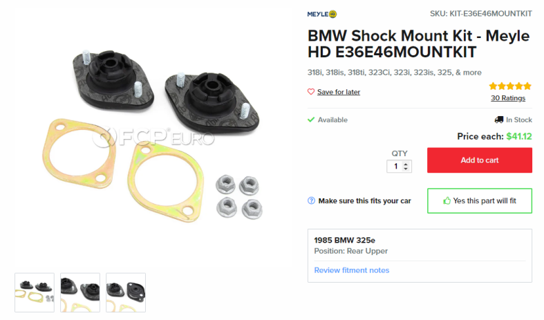

    these will fit and work safely. they are a factory-ish replacement, not an upgrade, but Bilsteins & H&Rs aren't very aggressive so they won't be a problem.
        I think that depends on the H&R spring rate and shock absorber. The H&R race spring rate is much higher spring rate. Add more dampening from a better shock and you have more force out into the mount.
        • Northern
          • 5128
          I would argue that the E46 Meyle HD are an upgrade. There's like a decade+ of forum posts saying they're more resistant to punching out and I've never heard anyone argue otherwise.
          Should be great with the reinforcement plates on top, and that price is great too.
