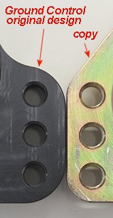

      Actually, you will have the exact same result with vorschlag because they are just a copy of what you already have. The bolt holes and spacing are EXACTLY the same as what Ground Control designed 15 years ago.
      You simply need to move the bolts, use smaller washers or notch one washer to move back to centerline.
      Only the Ground Control camber plate allows you to actually move POSITIVE if you turn the slider 180, but you don't have to for centerline. The other camber plates hadn't figured that out yet, but I guess the cats out of the bag now.
      The new GC camber plates are light years ahead of what you have, but with just a little careful thinking you can make it move wherever you want. This is not a quality question, just the new plates you don't have to swap washers.
