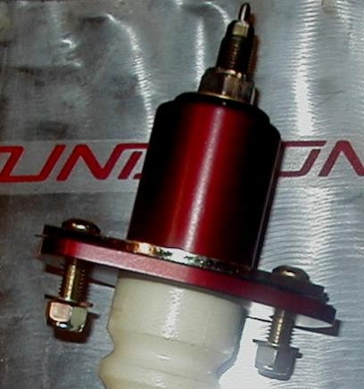

    i must resolve the issue of my rear springs being able to fall out everytime i raise the car, or possibly jump it.
    i heard of drilling, installing a cable through certain parts, but where, and how large a diameter on the cable, and if there is a guide or how-to, please let me know.

      You can use shocks designed for a lowered car, such as Bilstein Sport or Koni sport (for an e30, not for a Mustang) or, Ground Control has designed and sells a special upper mount to reduce the droop of the rear shocks.
      This pulls the rear shock up higher, the same as a "sport" shock, so the rear spring doesn't come loose.

          THANK YOU ALL...
          nice..i hoped there was a better fix than a scabby cable.
          so...
          what shocks exactly> anyone, (or how much for the extra rear mounts...(kinda blows b/c my shocks are fairly new)...
          so, in the meantime, is there a specific length of shock for different ride heights ?
          Jay from GC
          thyanks...i looked at the g.c. webpage, but did not find that photo...i did find the rear inserts, but the pic reported a very shallow style, and i did notice a few different sizes (from 10mm to 14mm.)..and wonder..which one is in the pic ?
