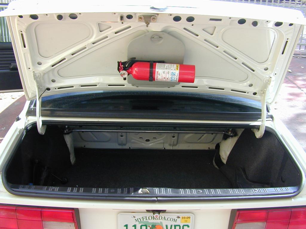

            looks cool, anything to stiffen the chassis.
            • vr2jetta
              • 460
              Thats a real good place for the fire extinguisher.

                      That picture is hilarious. I'm loving the fire extinguisher.
