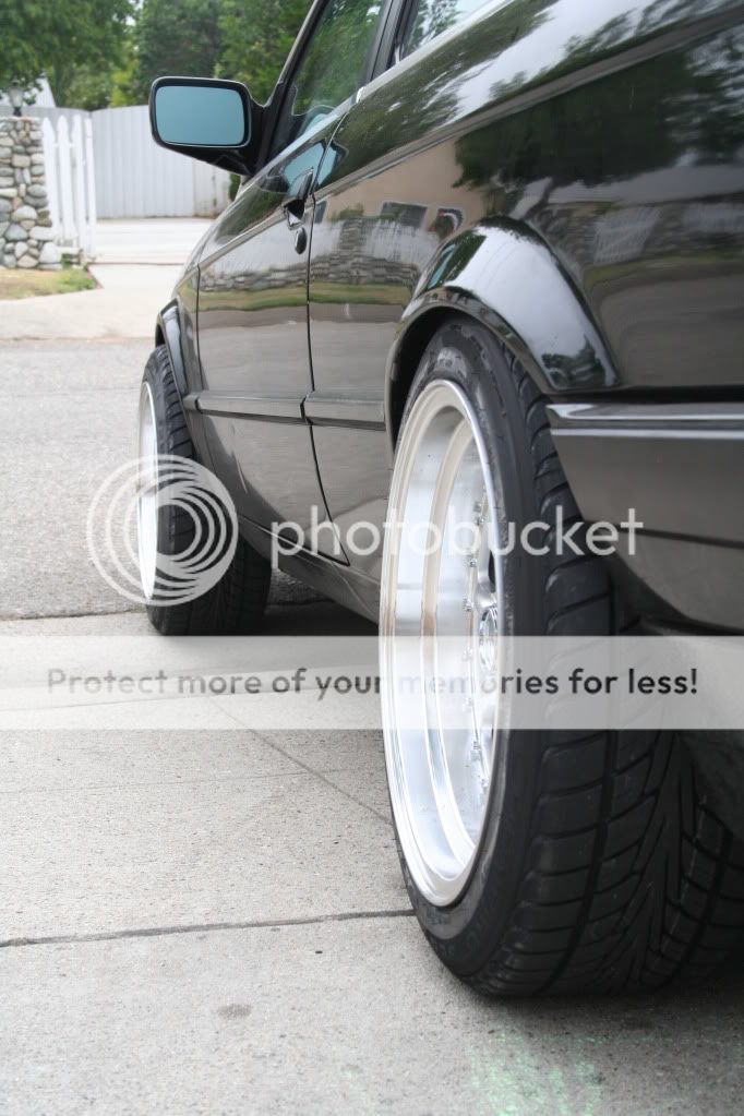

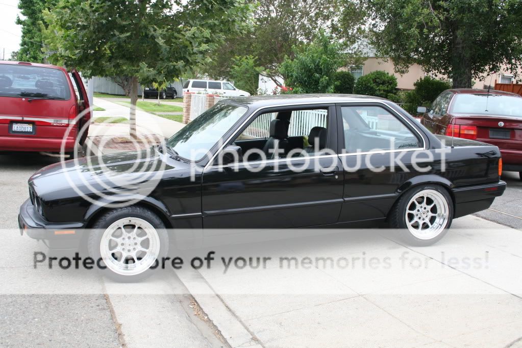

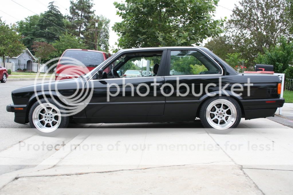

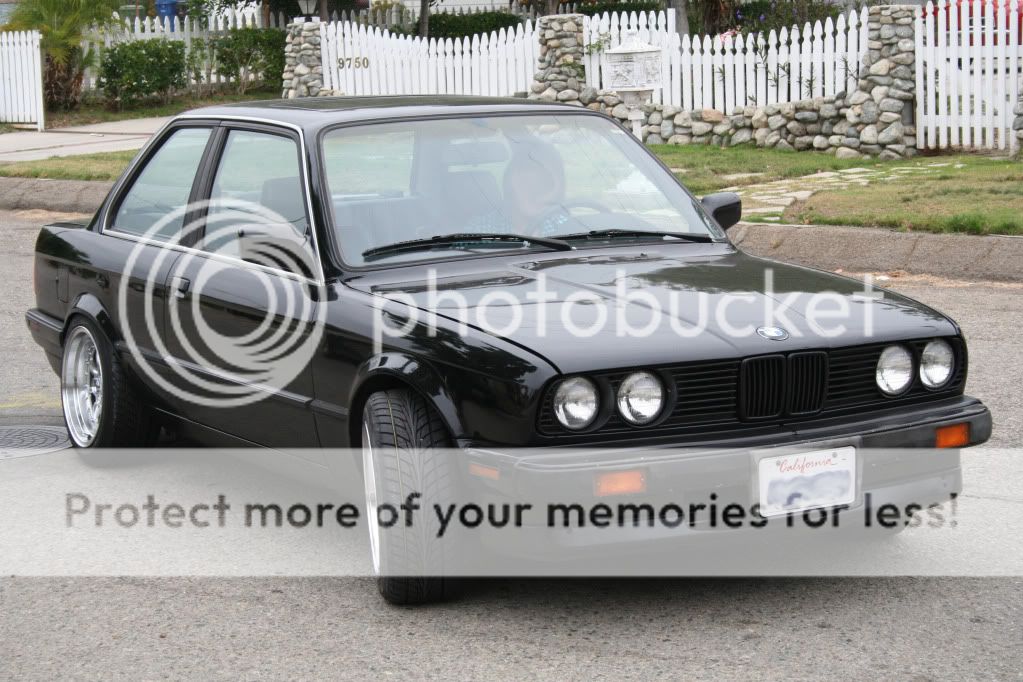

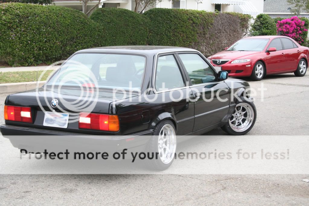

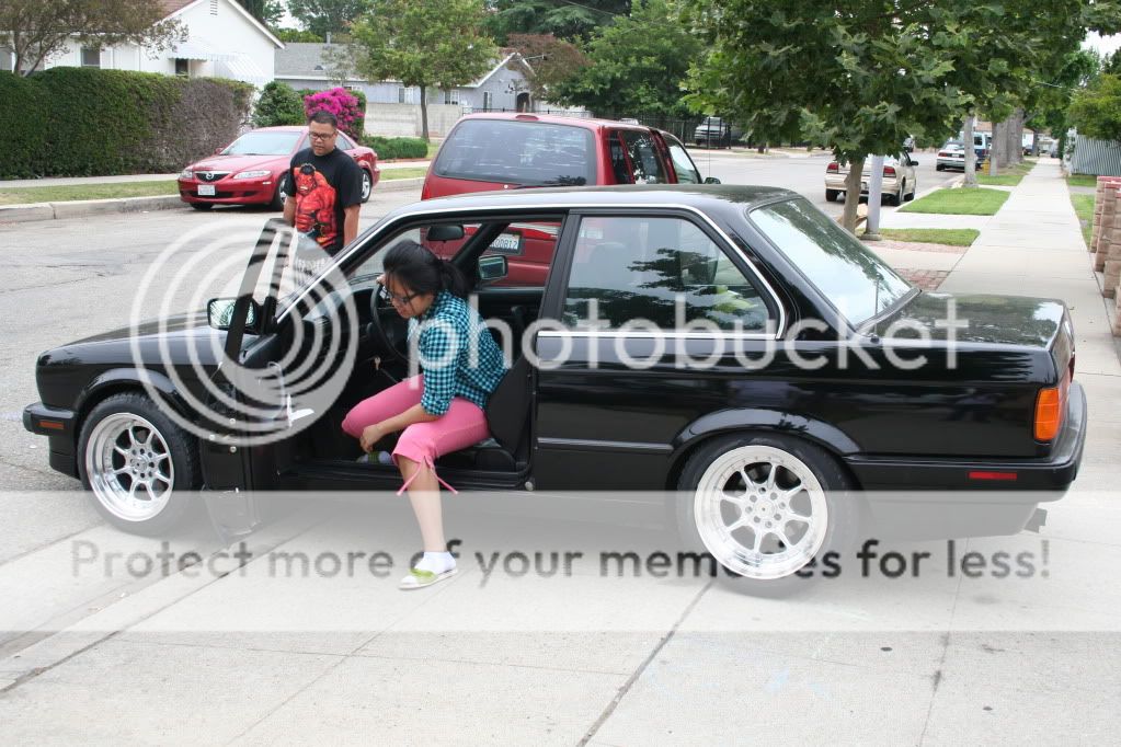

    Here is my dilemma.I lowered my car with 60/60 springs but the front is not low enough.So i thought of just removing my spring pads to lower it a little.What do you guys think? And by removing the pads,how much will it lower? And what do the spring pads look like?
    Here are the pictures of my car! I got some sportmaxx's on the car, so start the flaming!:-D

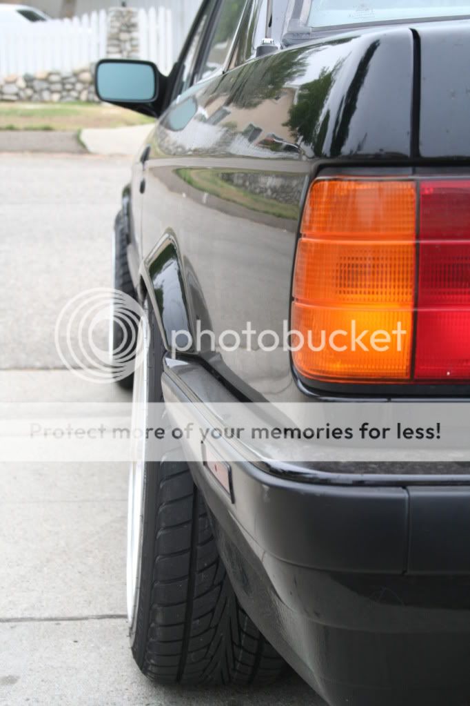

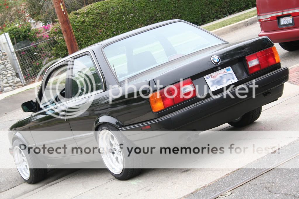

    The rear has a perfect drop:
    Thanks in advance guys!!!

    Your best bet to lower your car more is some GC camber plates. or cut one coil.
    But thats about it. Spring pad is only going to gain you maybe at most 1/4 inch..

                No one notices the early front end coupled with late model plastics and big tails in the rear?

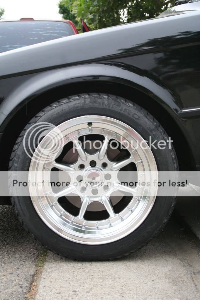

                  Champiro 328
                      Noticed, but didn't point it out. I'm guessing it was wrecked in the front end, Unless someone really loves DB's.

                        It was wrecked and he pointed it out in his other thread. Thats the way he bought it.

                          Try parking the car on level ground and it'll look lower...
                          Take out the spring pads, they don't make a huge difference but you'll notice it, they're easy to identify, rubber pads on the top and bottom of the coils.
