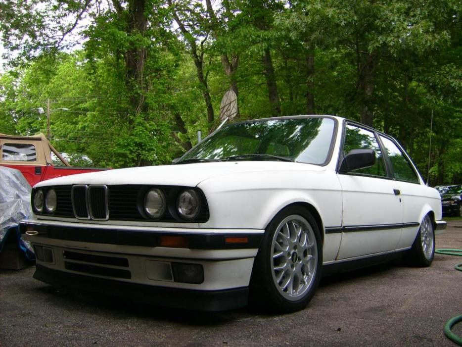

                        Someone needs to give me a cookie. I just searched for a picture to show everyone what I am talking about.
                        This is a car with no springs at all in it, sitting on the bump stops. His tires are 205/45/16, so slightly undersized. As you can see, the fronts still do not tuck and the OP's tires are even smaller. The only way to lower it more, is to get GC camber plates or go straight to coilovers with shorter housings.
                        -tim
                            It's byron's car!
                            e30spdfrk
                            I wear a suit, I do coke, and I ski...:D
                            That's why I drive a BMW
                              Damn, he doesn't drive that car right?
