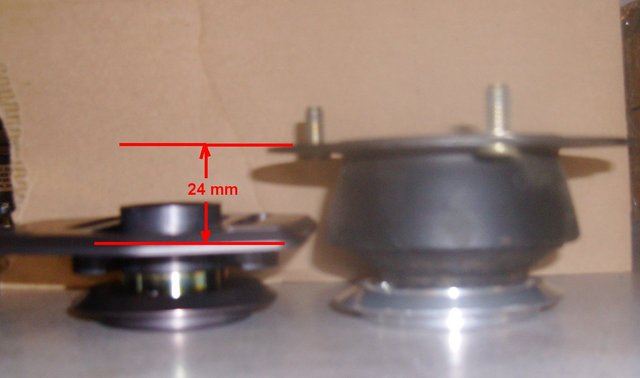

                      CAMBER PLATE

                        Thanks for all your help I decided I'm going to go with koni adjustables, gc coil kit, and ie chamber plates
                        • Philo
                          Ich esse kleine Kinder
                          • 3334
                          Get the GC camber plates! The IE's will raise you up a bit (from the pictures i've seen). GC camber plates are assured to give you an amount of drop.
                          GC vs. Stock.
                          -tim
