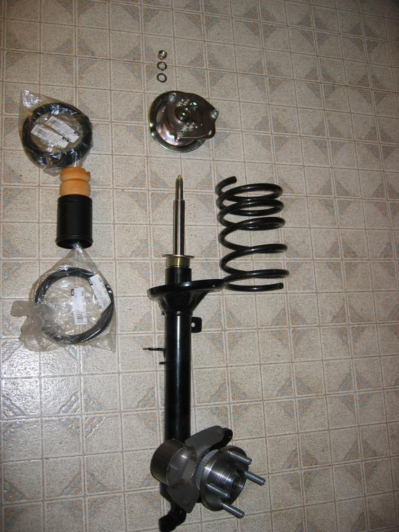

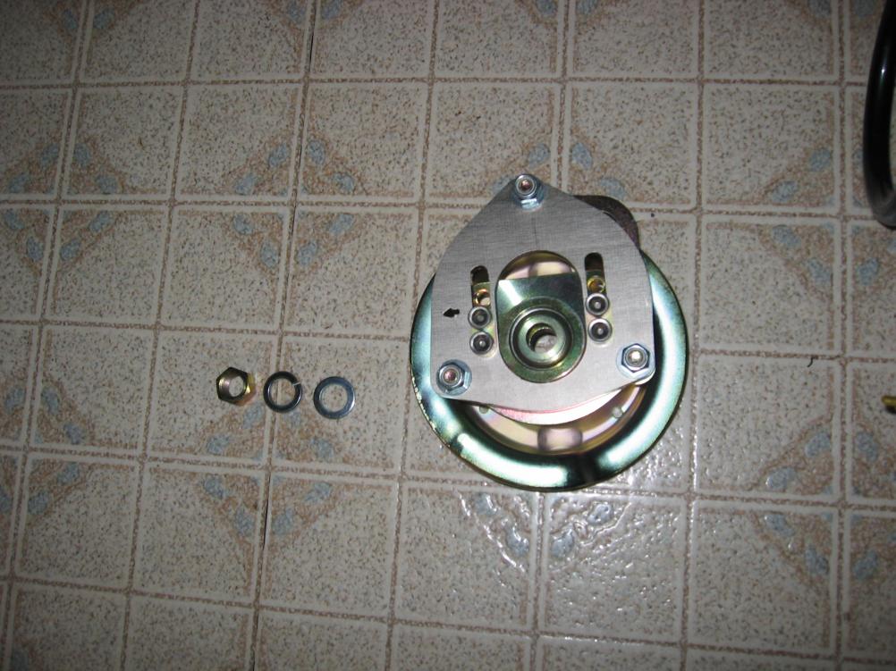

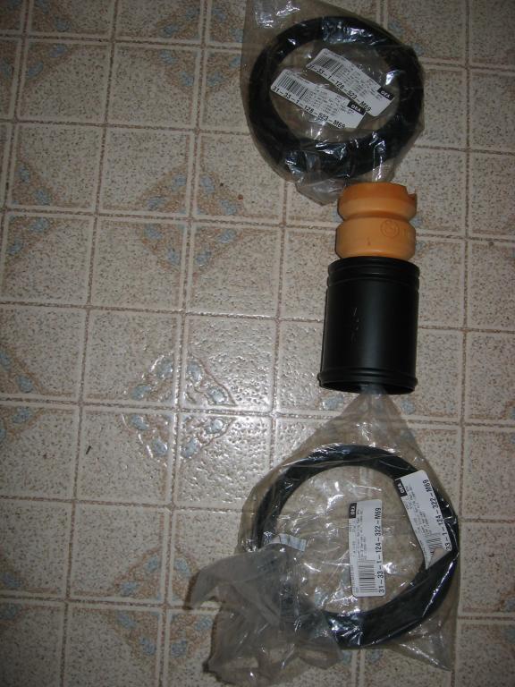

      front strut stack
      Jay, thanks for the help. Forgive the competitor plate in the photo (although that is a GC weld on m3 swaybar mount).
      Does this look like everything in order?
      From Bottom to top:
      Strut body
      ATF fluid
      Strut
      Collar Nut (the thing that screws into strut body)
      Lower rubber spring pad
      Spring
      Upper rubber spring pad
      Factory bumpstop with plastic dust shield hanging off the bottom?? Not sure I got the right parts here
      spring perch
      camber plate
      flat washer
      lockwasher
      top nut

      Also, I found these things on the bottom of my suspension box, and I'm pretty sure most of it came with the konis, but I don't know where they go. Any help?
      edit: I now realize the black metal spacer doohickeys below go on top of the strut body, under the collar nut -- right?

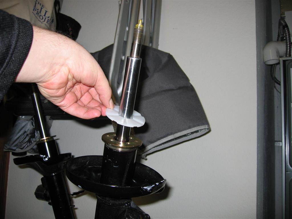

              The white nylon split washers are bumpstop vents. In certain situations the bumpstop, when bottoming, can actually suck oil from the damper and ruin the wiper seal.

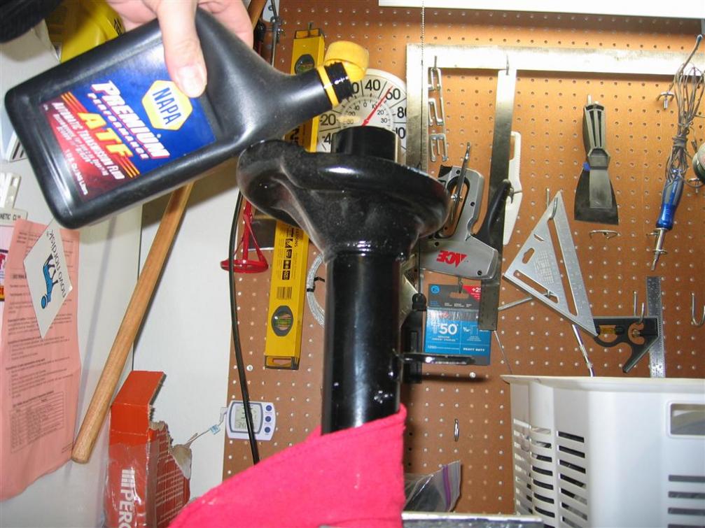

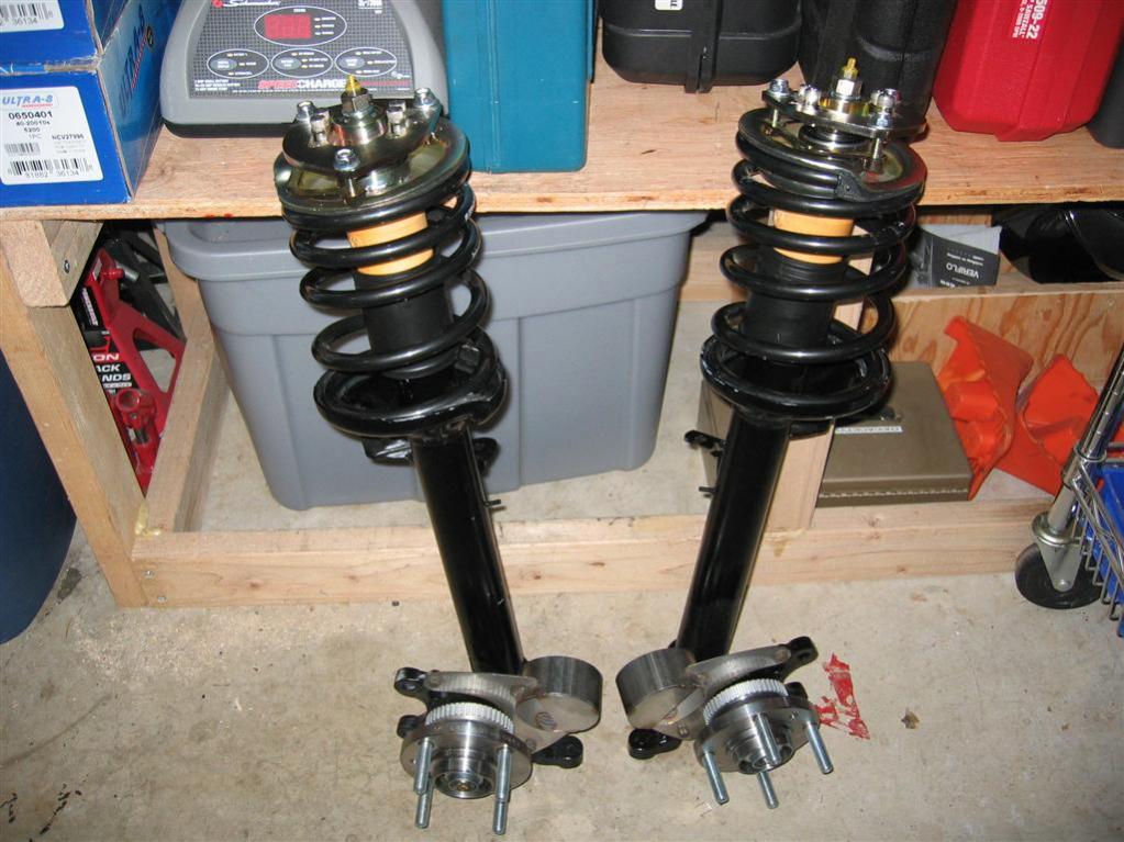

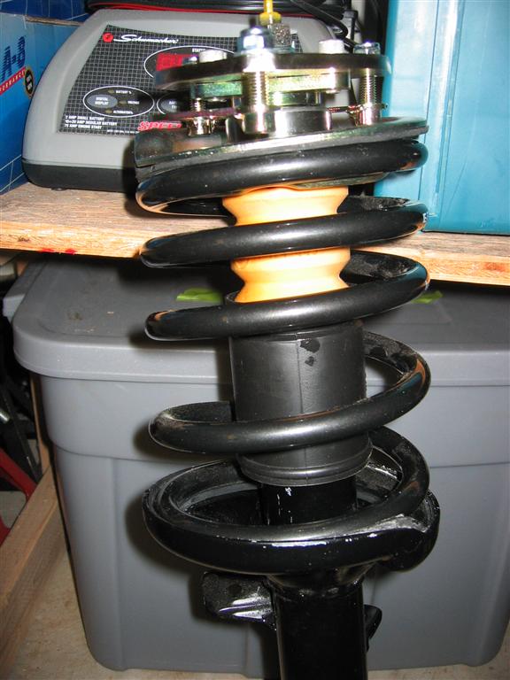

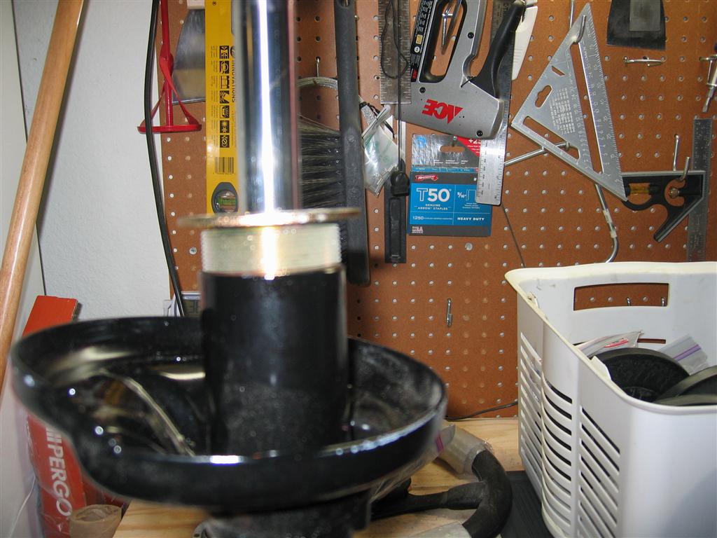

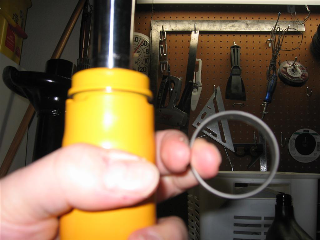

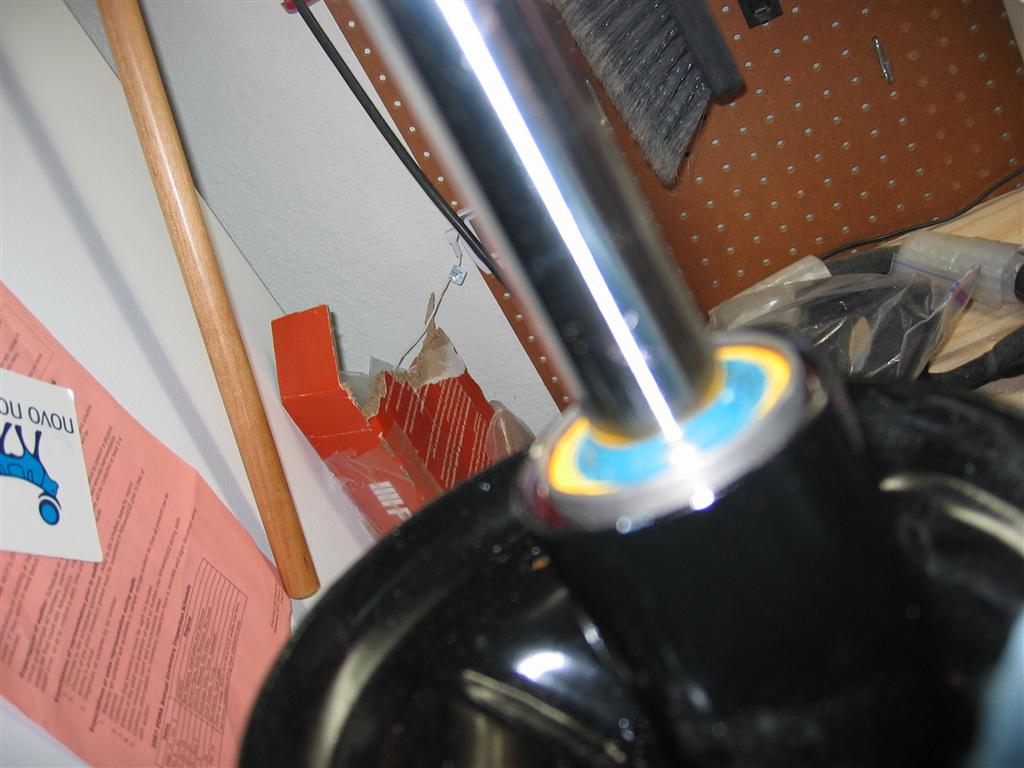

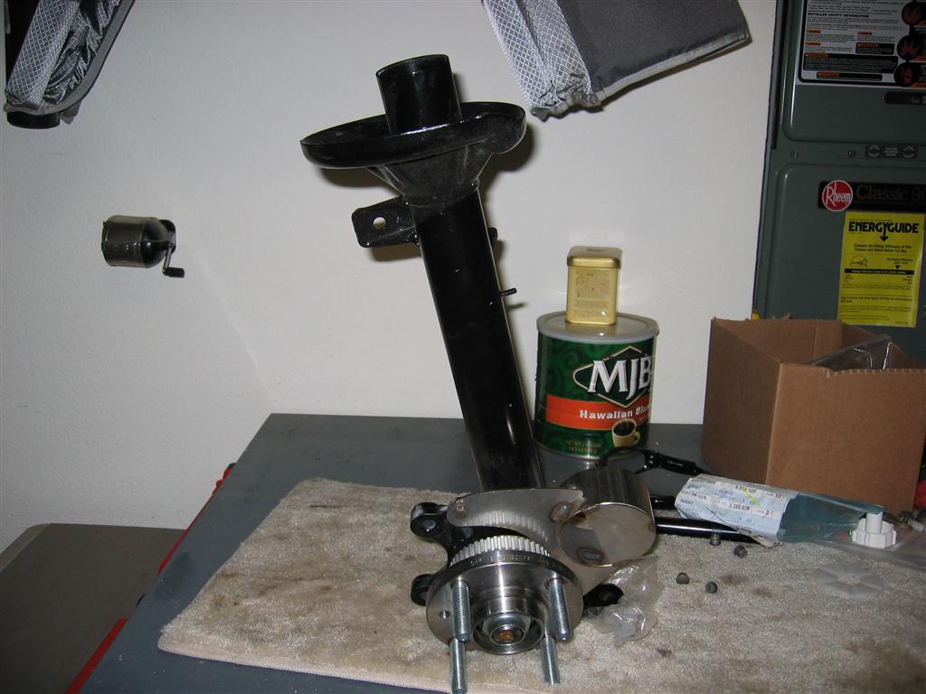

                    So I figured I'd just throw it together. Here are some pics of how I think it's supposed to go together. If I f*cked up, please tell me now.
                    ATF, 50ml is too much, two tablespoons is plenty.
                    Grey spacer collar on top of koni strut
                    Collar nut screwed down as tight as possible with monkey wrench. Does not screw down all the way, I assume thats OK.
                    White plastic washer on top of collar nut.
                    Bump stop, with plastic shield hanging from the bottom?
                    Rubber spring pad, Spring, Top spring pad, vorshlag perch, camber plate, lock washer, top nut.

                      • browntown
                        • Jun 2004
                        • 3524
                        final stack
Name:	koni 011 (Medium).JPG
