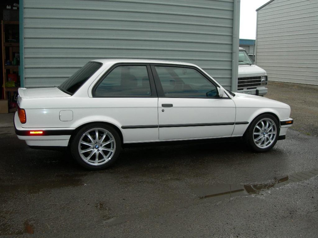

            Will add more than my 3 letter first post. I don't really like the IE. I have ST and I like them, it will be too soft for you, but I have their kit, I rode in one that had Billy Sports, felt a little more solid but probably still too soft. Go with the coil overs. Here's the same 4 year old picture I always post.
            I think they settled/sagged some since thing.

                do you have a side pic of the ST? they the 60/40 or 60/60?
