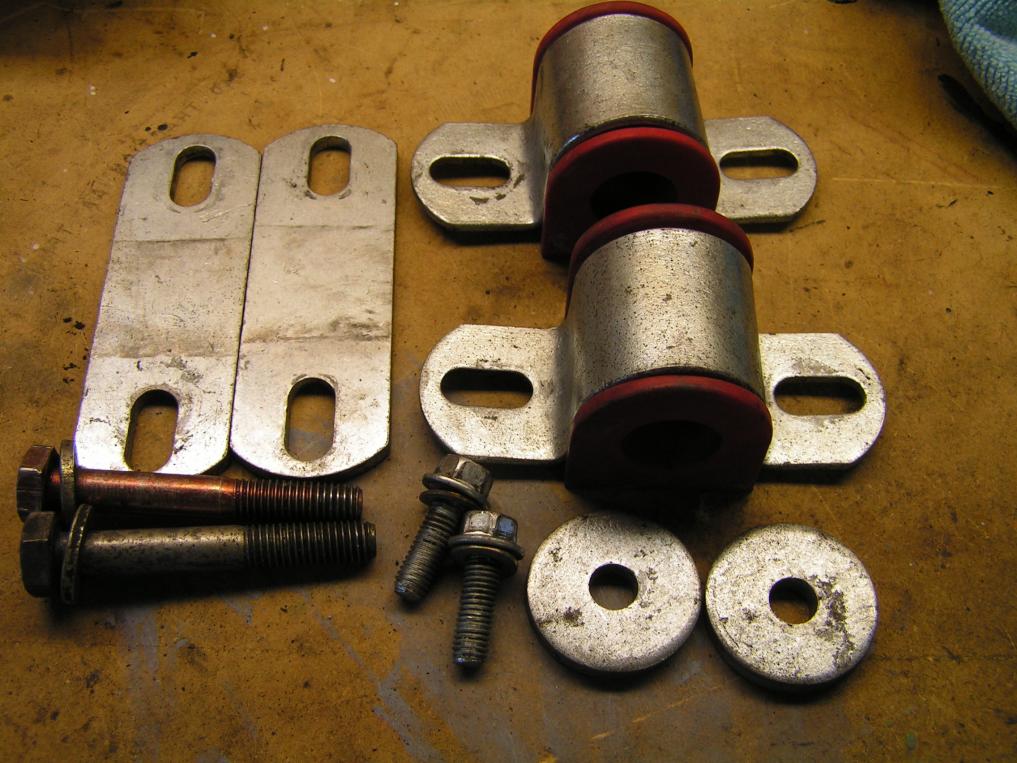

    I purchased a set of ST Sways for my 88 325iS and just now getting around to really start assembling the E30. Now somethings I know I need such as the rear reinforcement plates. I alos know I am 'missing' some parts so help me assemble so everything is 'right'.
    Which reinforcement kit does everyone like? Front sway will use OEM End Links correct? What sort of reinforcement(outside of the rear) will I need? What parts of the kit am I missing? Should I buy the little 'kit' for the rear? Front appears to have some sort of brackets and a bolt/washer. What is this?
    Here is what I have:
    Here is a full kit:
    Here is the rear 'kit':

          I'm pretty sure I've got the rear figured out. My question is re the front bar and where the large, thick washers go. I don't have the front endlinks either--what the heck do they bolt to?

                Yeah, I know the top one is the front bar. The washers are the round ones pictured here. Assuming the reinforcing plates go between the urethane mounts and the subframe--are the washers a spacer? If so where do they go exactly? As I said earlier, the M10 bolts pictured don't go thru them, so I'm confused.

                  Weird. I didn't have that piece. Installed the weld in reinforcement and bolted them on. Don't rightly know.

                        Those TA reinforcements must be welded on or one of the tabs will break. Ask me how I know. It's a good idea also to weld in a vertical reinforcement like what's in the IE sway bar kit. I cut up some sheet metal at work and made 1 horizontal and 2 vertical reinforcements per side. I don't anticipate having any problems with my sway bar tabs.

                          Yes. Reinforcements are needed in all 4 rear mounting areas.
                          The washers are spacers that go between the subframe and the mount. Install it and it'll become clear what needs to be done.
