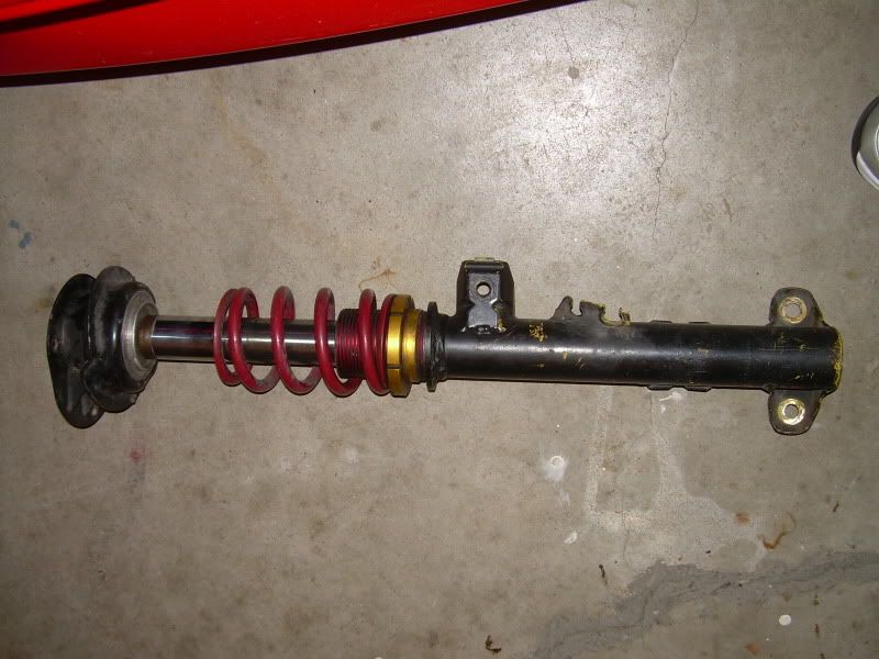

              Not to thread hijack, but I have front pair of CG's with 375lb 6"x2.5" springs that are currently on some modified M3 front housings. Will these work on an e30? The e30 has some old school, but revalved Koni hydrolics, so i know im good on dampening. Just wondering if i can get these to fit.

                You will need to remove everything from the housings, modify and re-use your old housings for it to work. Where in KS are you? I can make it happen for ya.

                  The adjusters are upside down and it looks like those are rear springs from an e36 kit by the shape and lbs. That would make them 2.25 and maybe why the adjusters are that way?? Should be able to get the numbers off the springs to tell.

                    checked the part no. off the springs, they are 475lbs. I didnt even look at the adjusters, lol! I have CG's on my Camaro and i didnt even notice this on these struts.
                    hey Philo, i live in Manhattan, ks. I know quite a few of the SCCA BmW autoX guys in KC. Do you know Doug Hitchcock or Chris Conant? Im not sure what im gonna do with these. Seems like a waste to get rid of them when i can put them on my e30. I'd like to just throw them on my Koni's i got on the car now without cutting the perches, but dont know how low i can get, Not really looking to slam it, just lessen the gap alittle more than stock

                      Were they 2.5 or 2.25 from the part#?

                        Those are 2.5's. 2.25's aren't barrel shaped.
