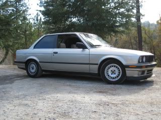

                        GC kit with stock struts all the way down with 6" springs...
                          So no changes to your perches? They look good!
                          • DRTSRFR
                            • May 2008
                            • 1836
                            ...just the basic kit.
                            Here it is now with the $1599 street kit and some Schnitzers. Can't say enough about the ride improvement...

                              Both these are at 23.5" ground to fender in front.
                              I could get the fender 23.5" off the ground with the strut tubes unhacked. This is half an inch lower than the diameter of a standard tire... so "gap" should be a non-issue if you run correct tires.
