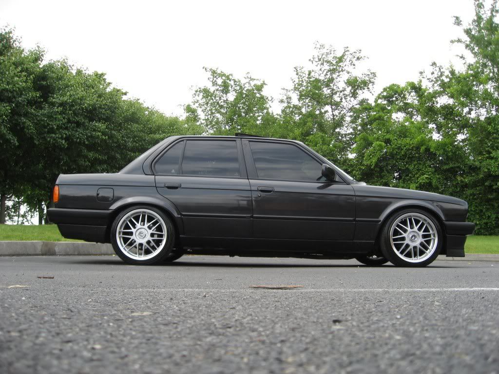

      The E30M3 springs don't drop the car very much, if at all. The Intrax do. I don't know how much, as they weren't on my car when I bought it (but it came with them). However, here is a picture of my car when they were on it:
      Drops it a decent amount from the looks of it.
      $75 + shipping if you're interested.
