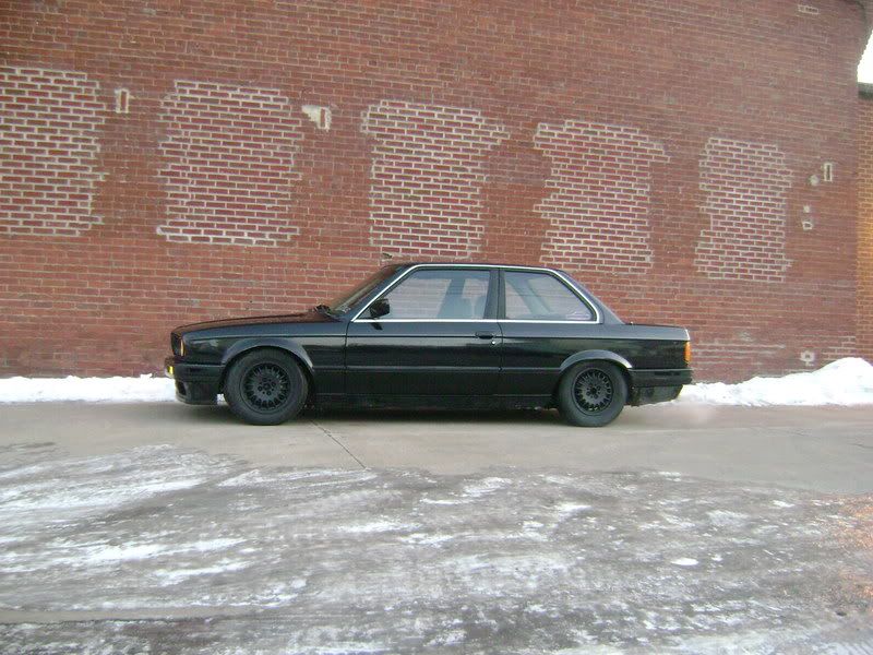

    In order for you guys to get a pretty low stance did you have to cut any coils off the springs or not? Assuming you didnt weld on the spring perch lower.
    When using Bilstein sports you can't weld the perch lower. I don't advise cutting GC springs, just sell the ones you have and buy new ones from GC @ the length and rate you want. It's decently low, but not slammed. Cutting one of the bumpstop ribs out of the front dampers will allow for a little more clearance to go lower.

      What did you use to get your stance that about all im looking for? Just enough to get the tires in the wheel well.
        Short body koni shocks and cut strut housings.
        Your not really going to get low tucking wheel unless your running a bigger wheel and tire setup that is bigger then the stock wheel and tire setup.

              Ground control coils, all the way down in the rear and for the front I dropped the perch an extra half inch. So I think I welded it 3 inches from the top of the housing and thats all the way down.
                So you think I could get away with welding the perch and inch down from the stock perch height?
                  Also why did the guy in this post say I couldn't drop the perch on Billy sports? Sorry for all the questions just don't want to put everything back on the car just to realize I need to do it all over.
                    Because you are going to bottom out your billies in no time.
                    -tim

                      what length and ID springs did you go with on the rear GC?
                        I went with the ones that ground control supplys in there coil kit.
                        I think its a 6 inch spring all around?!?
