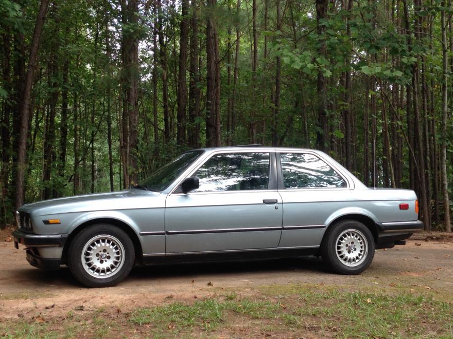

                          • mackETAttack
                            • Mar 2012
                            • 53
                            Here's my early model on OE sports
