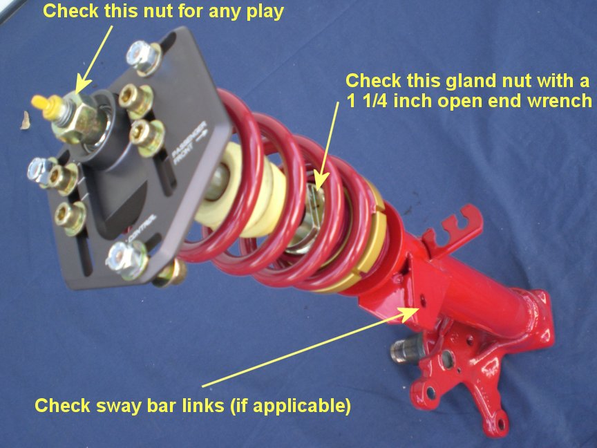

        Here are some pictures of what the strut bolt looks... I think its too far out.. Could this be that the jackass that installed them left something off?
        And if i turn it with a wrench it just keeps going out and not tightening....
        What the heck??

          the collar on the strut wasnt tightened properly to the strut housing?

            • Hellabad
              • 807
              This is for GC kits, so ignore the wrench size and use whatever fits your car.

              • caliGreen
                • 195
                indeed.. my strut was doing the same ( billys and Hr) it ended up being the screw that holds the strut and the strut housing... example would be that picture that shows the 1 1/4 i open screw..

                      I have the same thing going on. Running CG coil conversion with bilstiens and camber plates. Everything has been check and re-checked.

                          How is your threaded portion attached? Mine is just sitting on the flange and I was thinking that "could" be the cause. Thoughts?

                            Check realoem or something. There is a series of washers in that area, I left one out once and caused a clunking noise.
                              Do you mean the gland nut?
                              I just finished installing the front CG system w/Koni's and camber plates. The long spacer that CG supplied (the one that is inserted into the strut housing) was so long that the gland nut wouldn't catch the first thread.
                              I called CG and they said I should just cut it to length, which I did so that I could tighten the gland nut until it is flush with the top of the strut.
