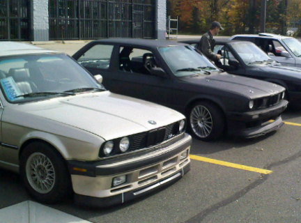

    H&R Sport with Bilstein HD
    16x7 et20, 195/50 Falken Ziex 912s

    Wow, that thing is clean.

    Bilstein BTS kit
    12.75 front
    11.25 rear
    Leave a comment:
