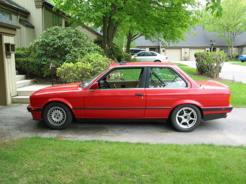

            Not sure if I posted on here or not.
            318is w/ M42
            H&R Sport (for a convertible 318is)
            KYB shocks
            Stock spring pads
            195 60 14
            fried chicken

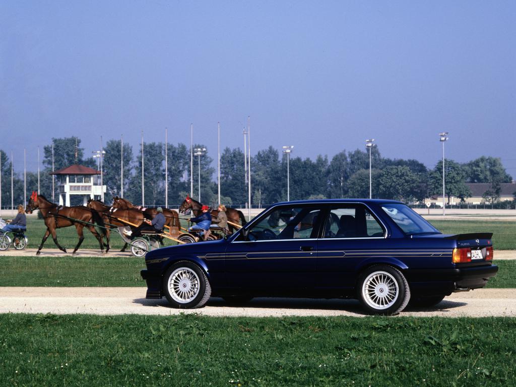

                    Hi r3v. I just found a great staggered set of Alpina wheels 16x7/16x8 and plan to run them on my late model 325is, which is currently at stock ride height with OEM springs and Bilstein HD. My question is how do I get it to sit exactly like this...? Spring recommends and advice appreciated.

                      just like that huh?......lol
                      ok..here ya go:
                      easiest way is HR race springs.....or IE stg 3.......both willbeclosetothat pic..maybe not egggzact tho
                      orrrr......buy coilovers and just set it where u want it.
                        ok..here ya go:
                        Thanks... will the H&R set alone drop the front enough to even out the gaps like the pictured car? I'm worried about the "reverse rake" look that the stock late model has.
                        • JRKOUPE
                          • Dec 2004
                          • 3159
                          #507
                          on my car it did..........you may have to play we rear spring pads a little ...cheap , and no biggie
                          buuuuut Hr race are not comfy on bad roads.

                            #508
                            no reverse rake here.........try to not see the frt wheel/tire combo........this is an old pic early on in her devt to track day car.
                            there are many ways to get it done.........
                            coilovers give you flexibility above all else.

                              #509
                              It looks like the rear arch sits over the tire, while the front has a gap. Aesthetically I'd like the gaps to be even, with an even little space between the wheel arch and the tires.
                              • MrBurgundy
                                R3V Degenerate
                                • Mar 2012
                                • 5376
                                #510
                                Get coils, I have h&r race springs with with bilstein sports and I have tucked rear wheels and the front has some gap.
