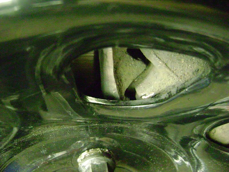

        I got tires mounted today, 205 50's in the back and 195 50s up front and it looks awesome. But now i need spacers for the fronts so they clear the brake caliper =[

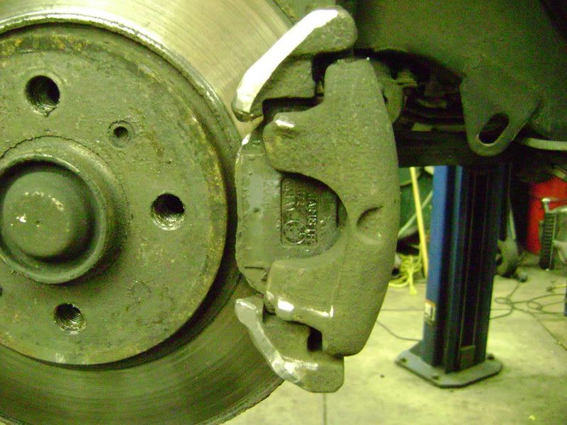

              No, you just need to take a grinder to the caliper bracket.

                      I actually left them at the place i got the new ones mounted, i think they hid them on purpose so i forget them, gonna go back tommorow. There 195 50 15's
                      Cant tell if your being serious or not
                      Originally posted by 325ix
                      I love the way your wheels look! What are they painted or coated with?
                      They came powder coated
                      • ak-
                        • 12422
                        No he's serious. Take a grinder to the caliper, just don't be stupid.
                        Grind some off, then take a sharpie and color your caliper.
                        Mount wheel and spin it.
                        Sharpie color will come off where it still hits.
                        And for the "$600 coilovers". It's just the GC kit.
                        Involves cutting and welding one thing.
                          I have ran 3 different sets of these wheels for close to 3 years.
                          Im being serious.
                          • Dude
                            • 1119
                            Awesome. Thanks guys.
