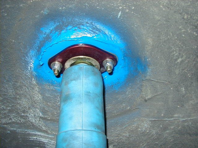

                    Attached pic of another previous repair. Note the bottoming out Bilstein in the pic.

                      The cause of that failure is bottoming out of the shocks, not from a failed shock mount. And the cause of the shocks bottoming out is the wrong shocks used or spring rates too low for the degree of lowering.

                        Let me take this opportunity to ask Jay since he posted the picture...Is the rear shock mount in this picture assembled correctly? I have the same mount and noticed the bushing diameter is smaller than the stock mounts so that bottom washer is larger than the bushing and will bottom out on the mount itself on shock compression. There's maybe 1/8" gap between the mount and the bottom washer. After that, the bushing is taken out of the equation and it's just a solid mount. So i'm curious if there's a smaller washer used or a dished washer?
