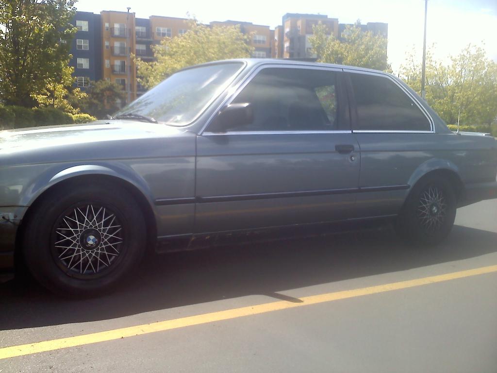

          This is JPlue's car, 5" 700lb rear spring with no adjuster.
          Byron

                    --thanks for the pic e30spdfrk, that helps alot.
